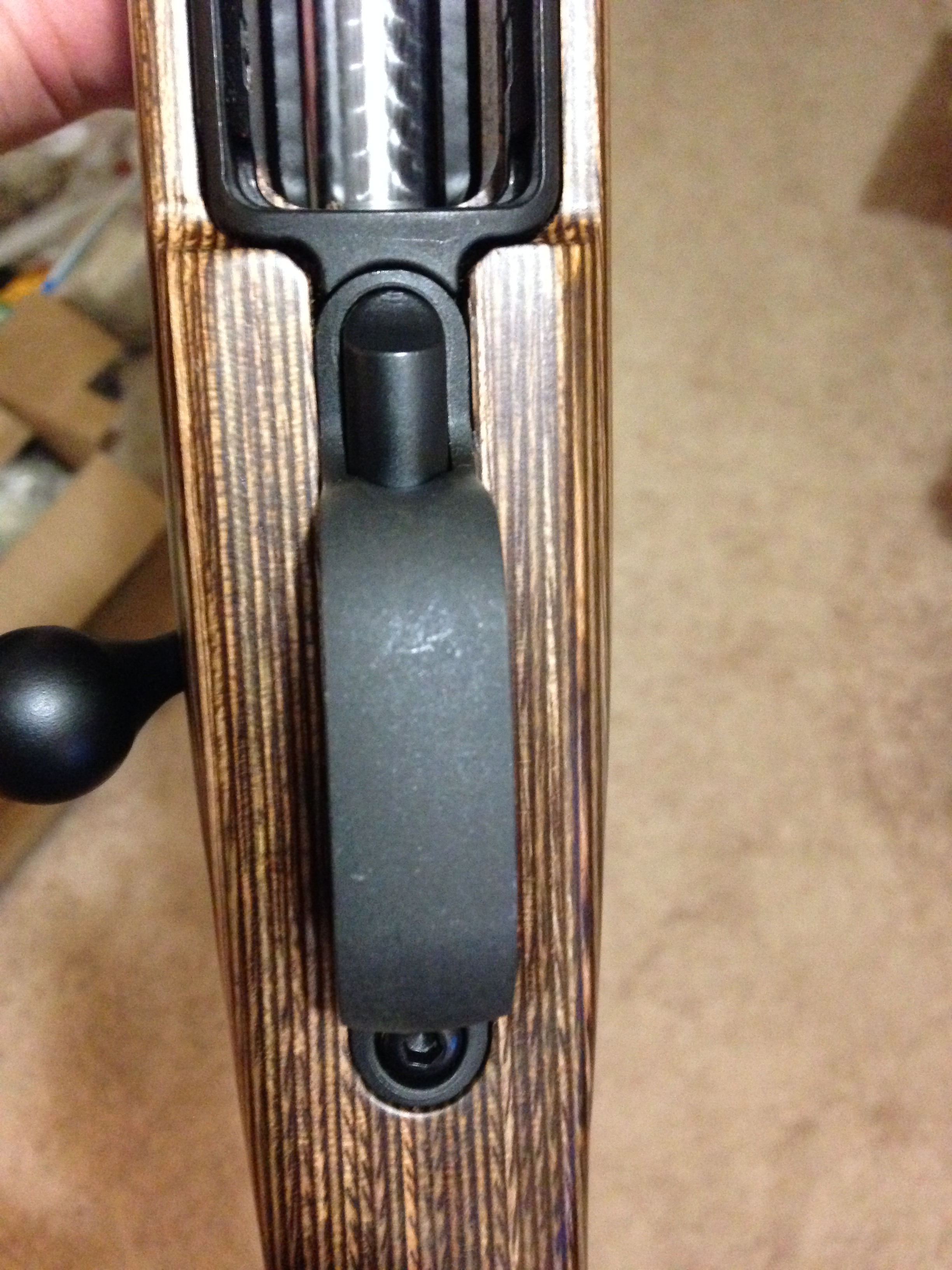

Here you see the bottom metal frame needed (1st) and the front bolt release in front of the trigger guard (2nd)

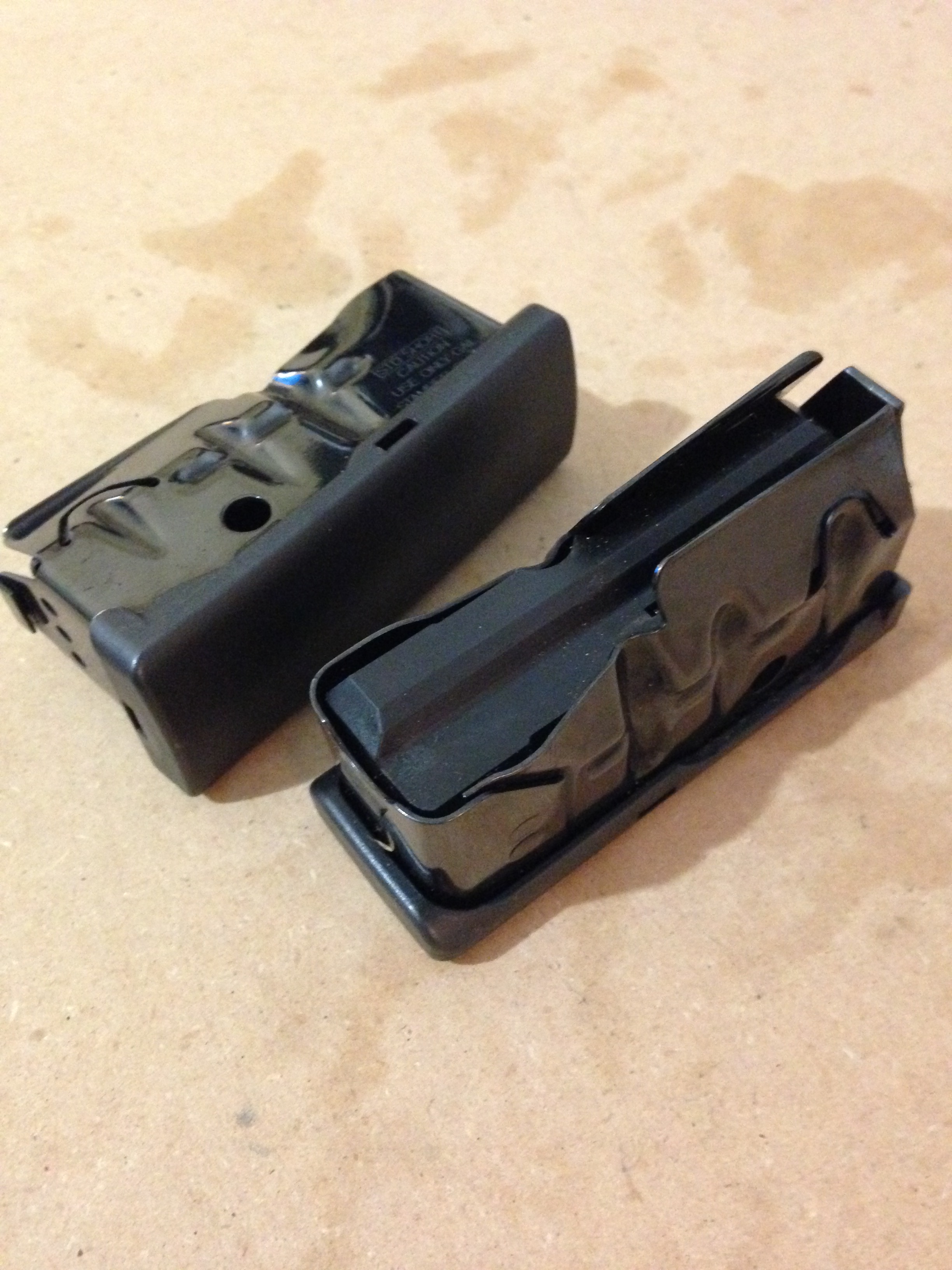

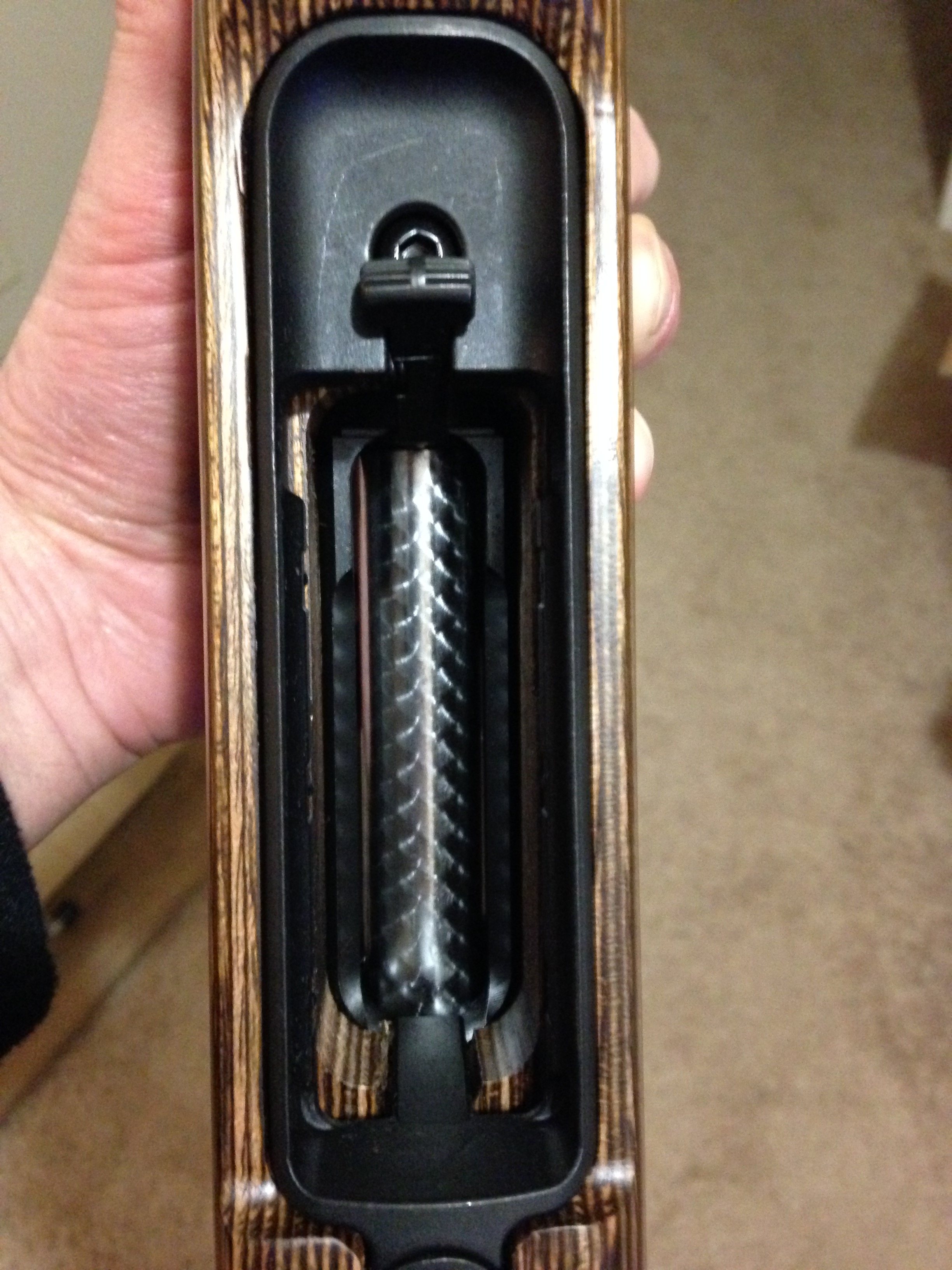

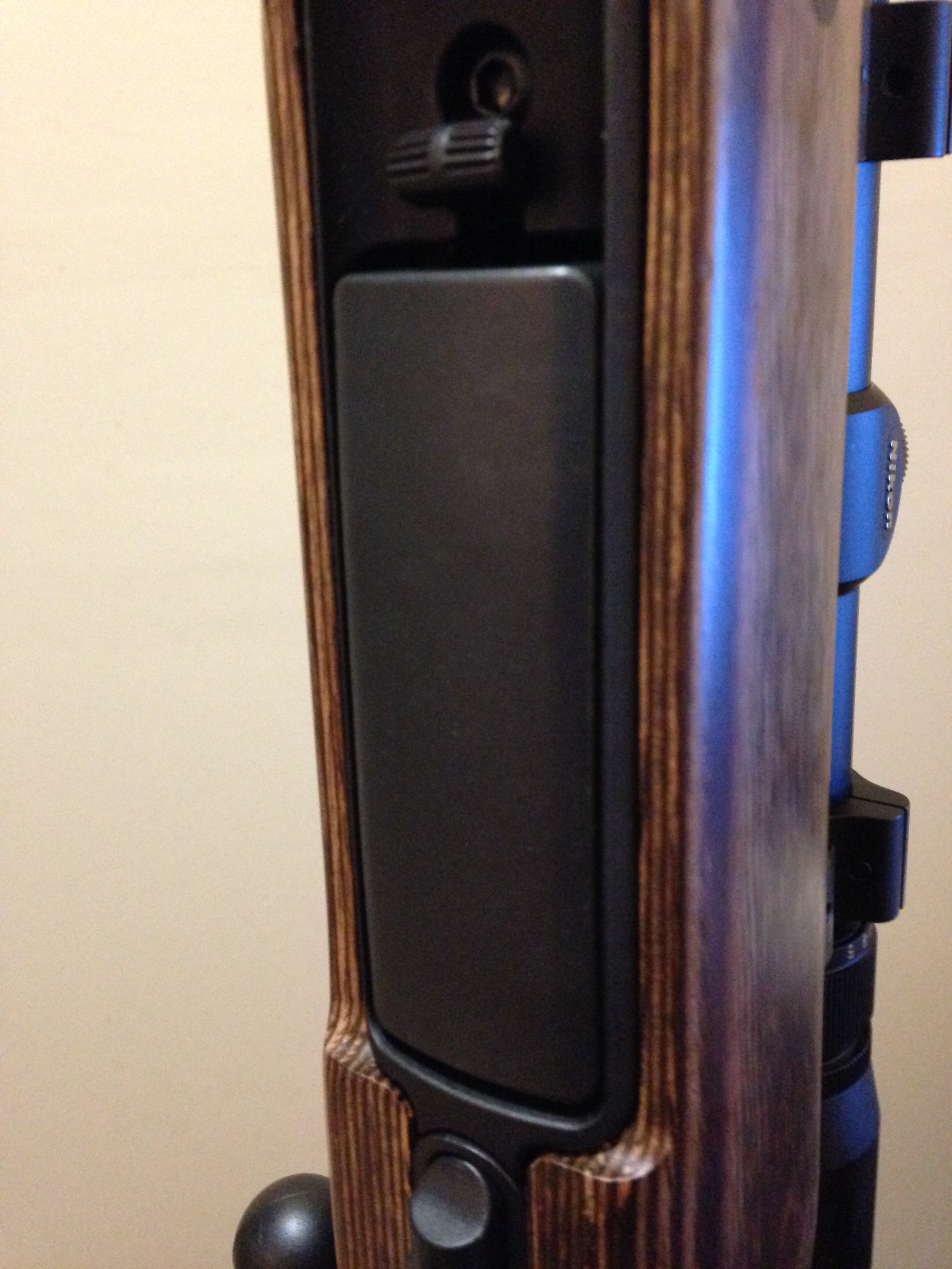

Here is the magazine with the new metal bottom cap (1st) and that magazine loaded into the new metal bottom assembly (2nd). "Click".
The extra parts required to mount this specific Boyd's stock for the 11/111 Trophy Hunter XP are: a metal bottom frame assembly and a metal magazine bottom cap. To keep everything consistent I ordered a replacement metal trigger guard assembly as well to replace the plastic one. Ordering these parts from Savage Arms USA cost $148 USD ($190 CAD) total including shipping.
