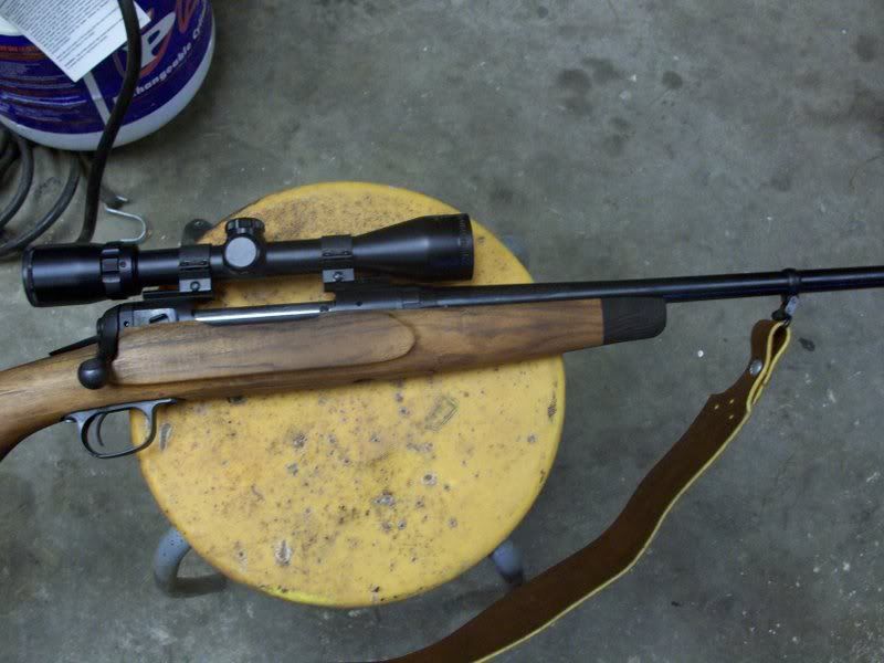

On my Stevens 25-06, which I'm pretty sure is the exact same action length as the 30-06 Savages, I had to use weaver extension bases for the reason you just stated. I don't mind the look of them, and have had no trouble at all with extractions.
The other options are to get a one-piece weaver base ($80ish depending on brand), and that will give you every possible option for mounting positions. Secondly, you can get a scope with a long tube. It's getting tougher to find those, as everyone seems to be making "tactical" length scopes. Thirdly, you can use extension rings.
No worries dude. I had to go through all the bull#### of figuring out what worked, and what didn't, all by my lonesome:D. Made quite a few trips back and forth to the gun store...
The extension bases were literally the cheapest solution, as I think they cost all of $4 each. Some people hate the look, others don't. Like I said, no problems with extractions, and they are holding up great. Loct-tite the hell out of them and you are good to go.
