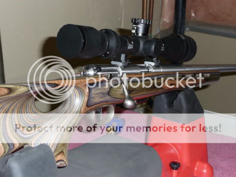

I bought a Savage 93R17 BTVS and I have it paired with a BSA Sweet 17.
I have tried three types of rings to get this thing to boresight and the sighting grid is so low it doesn't show up in the scope, even on 3 power!
Anybody else experience this? Shiming it isn't even an option as it will put the scope and such a drastic angle that tightening the rings will damage it. Actually its so drastic that you cant get the rings to close.
I bought the rifle second hand but never fired. I had to stand 25 feet from the target to get it on the cardboard. I would guess its shooting four feet low at 50 yards and thats being conservative. I'm going to try another scope out of curiosty but I'm wondering if its the gun.

Those pics are my set up including the rings, identically! I tried this set up at 50 yards aswell with nothing on the paper at all. Then I went back to 25 yards on the bench with nothing on the paper then I walked up on it and tried it just to see if its high or low....its real low. There isn't enough elevation in the scope to get me where I got to go.

I did what was suggested by sighting through the bore with the gun in a bench vise. Had to shim scope base and rear scope ring to gain elevation for the turret but I've got it lined up with the bore and scope with room in the turret for adjustment. Now out to the range and put it to the test.
