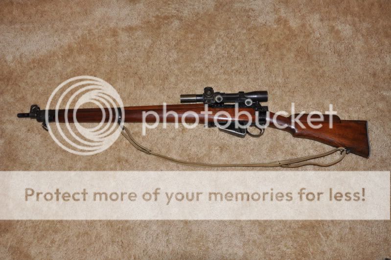

Here's the 1942 Savage No4MK1(T). My Uncle picked this one up shortly after WW2
at a surplus store. He thinks it was sometime between 1946 and 1952.
Talk about accurate with this one at the range!
What can you tell me about the scope's maker (No32 MkIII, AK&S, /|\ 1945, and the red painted bolt/screw on the bottom?
AK&S - A. Kershaw & Sons Ltd. (Soho Ltd) Now google becomes your friend.
Is the red a 'W' about 1/2" high. A red W indicated a scope with better sealing making them more waterproof.
EDIT nubmers of Sniper models produced by maker.
No4MK1 & 1* (T) w/ No32 Mk1 - 1,403 - Enfield
No4Mk1 (T) w/ No32 Mks 1,2 &3 - 23,177 - Holland & Holland (BSA and Longbranch did do some of these)
No4Mk1* (T) w/ C No32 Mk1, 1A, 2,3 & C No67 Mk1 - ~1,000 - Longbranch
No4Mk1* (T) w/ Lyman Alaskan (No32 TP Mk1) - 100 - Longbranch
