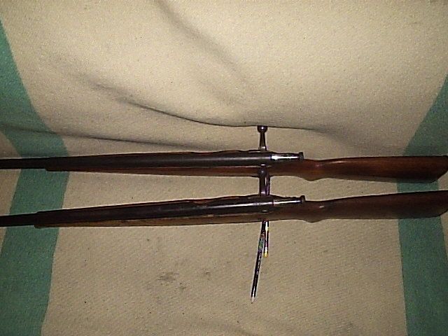

Well, they are here! Pictures when Camera's batteries are charged...
Turns out, these are probably model 22sporters. No sights, need some other parts, but surprisingly clean (probably made between 1919-1923). They are not identical in profile. One has a slightly shorter, but heavier barrel.
Cool thing? Receiver, and barrel are one piece. Very solid. They have a series of 4 tapped holes across on the top, so I'm thinking bases n' optics are the easiest way out.

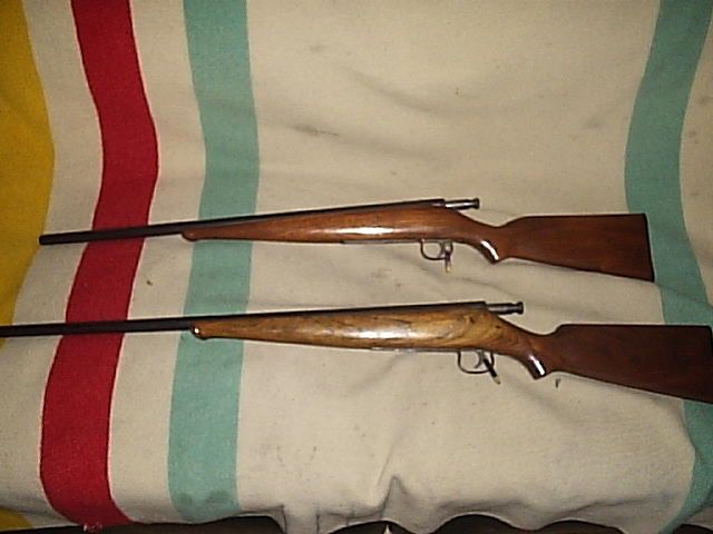

Some quick low res pics

Pretty nice find Cam, Like Maddog says they look like 1922 models, small ejection port.

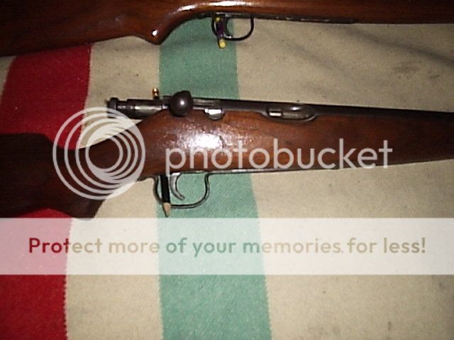

MADDOG : When you suggest the bolt is "flat" on the back..what exactly are you describing? The knurled cocking piece on these are actually concave.
Yep, those are what I call the flat backs, they're 1922's alright, nice grab.
