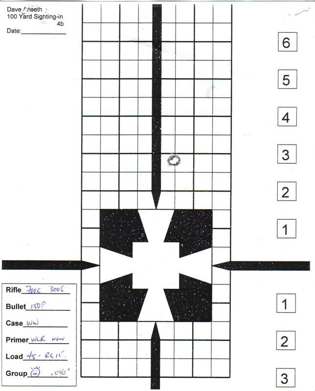

The 300 Savage and RL 15 seems to be well matched.
I have a bolt action 300 Savage, and my very best loads [velocity & accuracy] are with RL15.
The 300 Savage seems to be much like the 308 when it comes to powders that work well.
And rightly, it should be, since, other than the neck length, the two cases are very close.
