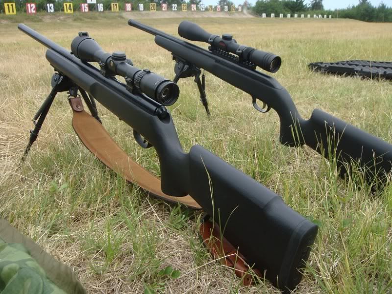

Martimes
Who bought these? Seems not much love for these. I think they look cool.
They're extremely accurate, but are ignored by the masses because of the dearth of aftermarket accessories and parts compared to the Ruger 10/22. Being limited to 10 round magazines also limits their appeal.
I like mine, but as has been said- reliable and accurate. They are an updated 64. New shape to a wooden stock that they painted black. 16" threaded barrel with some fluting. Not anything that is ground breaking. It's not "tactical" which catches everybody's attention. It still uses the standard 10 round magazine - no 25 rounders or 50/100 round drums. It doesn't look like an AR or an AK. It's not modular with railed fore-ends that you can hang lazers/lights off of and swap out the uber-cool folding/adjustable stock. It is just an upgrade to a tried and true dependable design.
I didnt find mine accurate at all...so its gone .The stock is very similar to the Boyds Tacticool I put on my savage 93 22magnum.

threaded barrel is a bonus and the balance of the gun is actually very nice.. Just need to maybe upgrade the stock and someone needs to come out with a large capacity magazine for it.
Very nice and accurate rifle, ergonomic and beautiful stock, reliable.
What's not to like?
