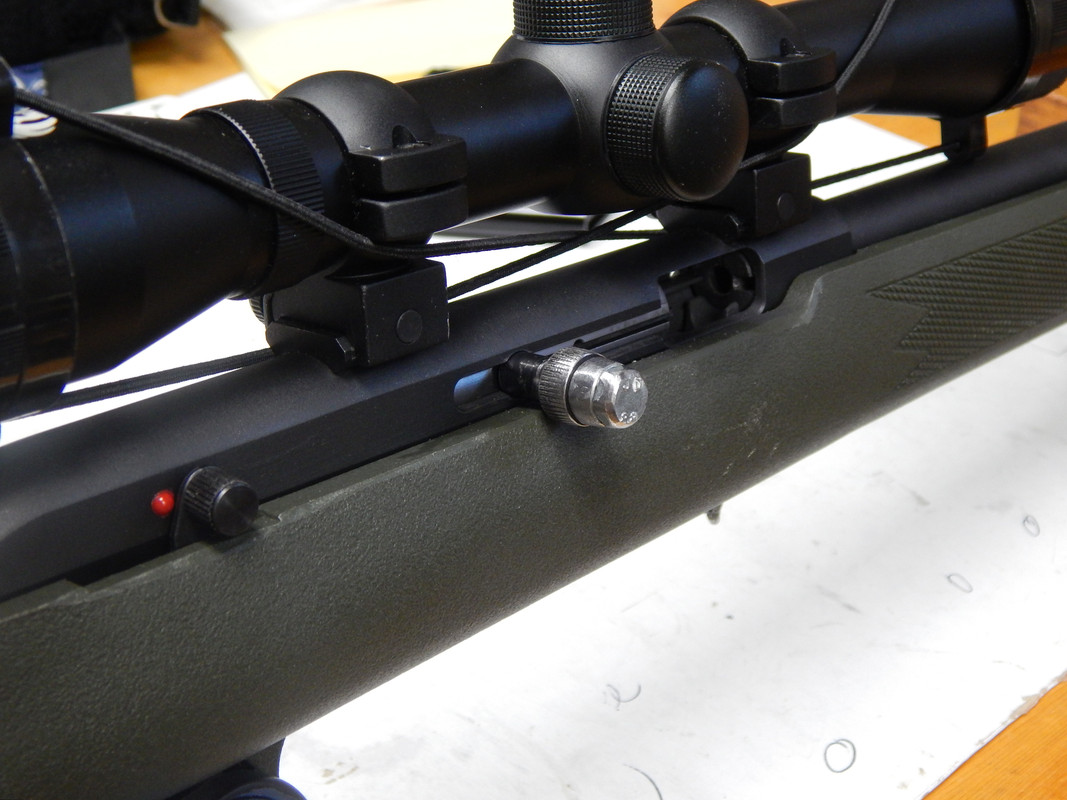

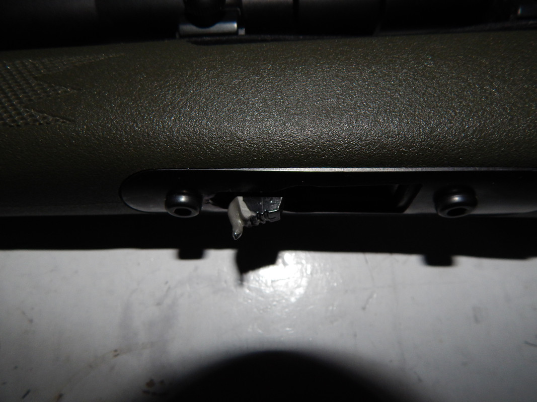

Today I took newly acquired Savage 64F ( from Coolguy435 ) to the range to see what it could do. I know the 64 gets a bad rap from the mags, to jams, ect.... I have solved this issue. I field stripped the rifle, polished/de-burred the bolt, feed ramp, extractor, firing pin, & took the dremel to the magazines. I also installed a Mcarbo spring kit. As you will see from the video/pictures it's very accurate ( in my opinion ) for open sights and cycles perfect with three different magazines & various ammo. I shot roughly 150rds today without 1 ISSUE! No ftf, fte NOTHING! I absolutely love this rifle! All factory targets were shot from the bottom right corner working left then up and repeat....
This is going to make a great lil hunting rig for chickens & rabbits!
The videos, are just to show that the Savage 64 can cycle perfect without all the dreaded issues....
I give the rifle a 10/10 after today! I'd recommend the gun to anyone. ( But would do the same as I have to help with feeding issues & cycling. )

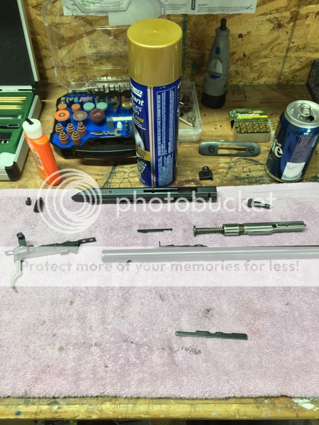

Field strip/de-burr & polish...

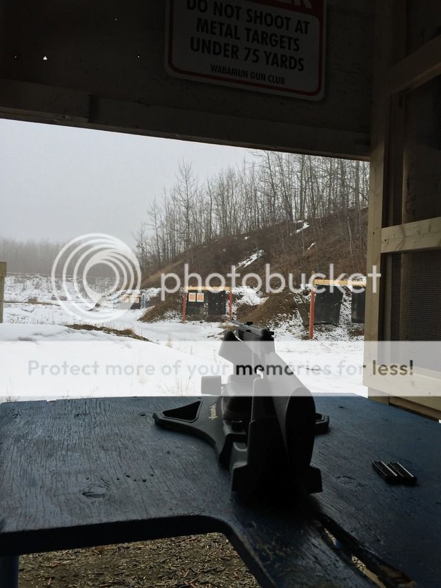

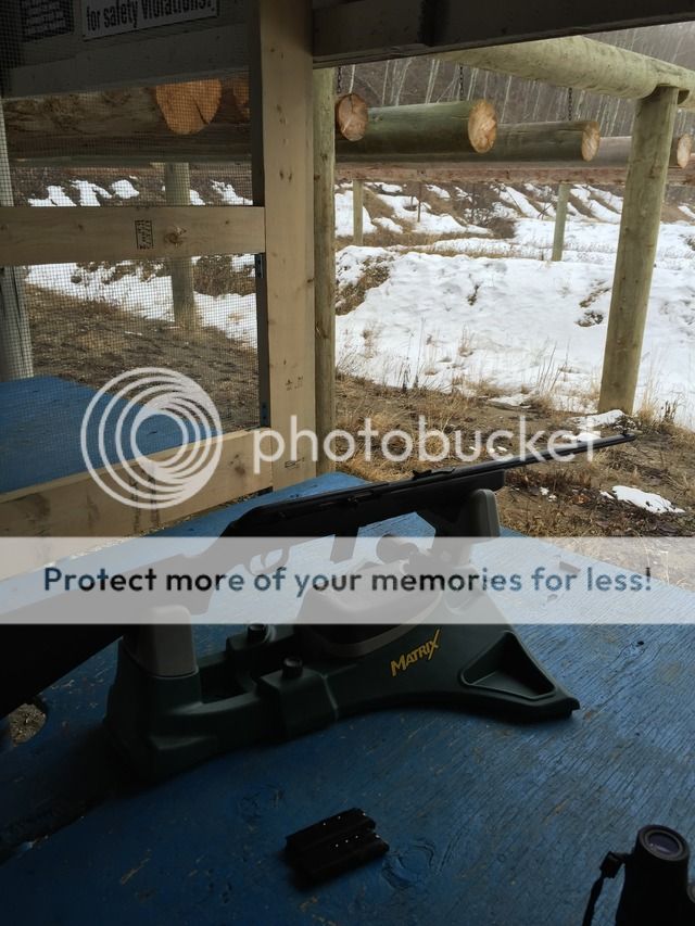

The gun & rest used....

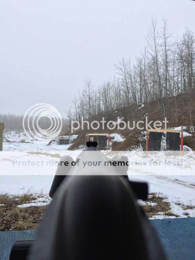

Down Range....

Yep, overall these are great little rifles. As your pic shows, very simple to strip down and clean. I've found that filing the feed ramps on the magazines often solves all ammo feed problems. Some mags work well as is and no filing needed.
Been shooting one for over two decades. I find the charging handle alittle small and abrasive, especially in the cold if your shooting a brick (500rds) of ammo or two. Best addition I made to this rifle is an extended, smooth, finger friendly bolt handle I picked up last year from CGN'r 'Johnnyc14' :

Very nice review. I have a buddy who has a Cooey 64B and there the same rifle . he loves his . if you keep it clean and feed it decent ammo it will serve you just fine. I noticed you are using Yellow jackets .I shot a lot of stuff with them years ago . they work great. are you using a buffing paste or the stones with the dremel tool ? I saw a 64 B made for Sears a few shows back . it had a little surface rust other wise it was mint. he wanted over $200 for it . I passed it up .

Some Prussian blue on the ejector (part 82 on Numrich) and some careful polishing plus very careful alignment of the tip of the extractor with the geometry of the barrel made a couple of mine perform flawlessly - even with lower energy ammo.
The slightest bit of drag on the bolt travel seems to cause a whole number of issues so I've found that working top to bottom (bolt, then feed ramp / chamber and magazine) gets them running well in the shortest time.
Shouldn't have to do this kinds stuff but it's a great learning experience and satisfying once you've nailed it.
It's been 3 years since I posted this review. I am happy to say this 64F is still working flawlessly. I keep it clean, really clean & have done nothing else to it since the review. For the one question, yes I took the dremel to the bolt to debur & polish. My ONLY complaint is loading & unloading mags. I have sliced my thumb many times. It has some sharpe edges.
wheeler, Thanks for the info and pics. Really good groups for open sights. :) I've had a 64 for a couple years and went thru the mag problems. I've measured a 'good' mag and 'rebuilt' a couple others to match and they now are OK. Savage CS sent me 3 new ones this Fall when I complained about them wearing down from use. I use a very fine file to break the sharp edges for loading and if you load with the bullet vertical then flip it into the mag you can avoid the sharp edge too. I threaded the inside of the charging handle and screwed a 1/4" bolt into it, then filed the hex head sorta smooth. That's worked the past summer, several hundred rounds. And I drilled the mag release and stuck a bit of hanger wire (less than 1") into it with JB for 'glue' and 'shaping'. Sorta bubba, but saved over $50 for mfg parts.:cool: Now best groups are around 1/2 " @ 25y. w/ 4x airgun scope:p. BTW those are 10 shot groups.

Hi Wheeler - I'm still running my 64 too ! I'm running a Vortex 4-12x scope now and if I'm careful I can do 1/2 - 3/4" groups @ 50-yds. Even a few under 1/2". I put a MCarbo sear spring in due to the 'clothes-pin' spring and replaced the trigger-return spring with a bit of a clik-pen - only about 1/2 of one. The trigger is now under 3#. Recently I got a replacement firing pin from Savage-Canada (CS was very helpful, but the pin didn't help me) and modified the 'old' one to move the striking point away from the rim toward the centre. I was having 'bad strikes' every 2-3 shots, but now it's firing all the time, over 500 rounds later. Also, I polished everything inside the action on 1000g wet/dry paper, even the pivot pin and it's hole! Just be careful of the 'sear face' - don't change the angles! Trigger is very smooth.
