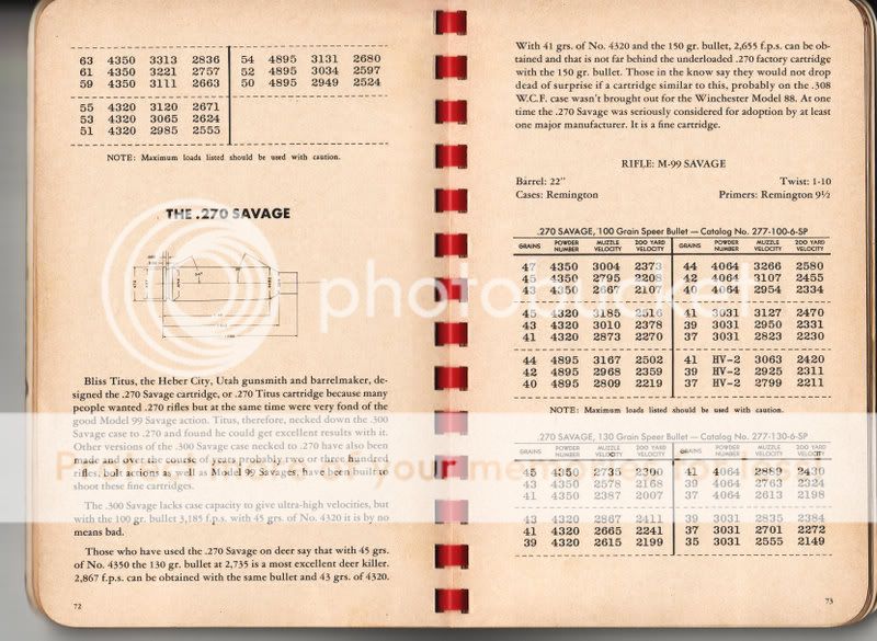

I found tis information in my copy of the Speer #2 manual for wildcats. Enjoy:)
jim: The data mauser 98 provided is exactly what you need with a bit of caution. Loads using 4831 in that book are probably arrived at with original military powder. It was quite slow burning. I think H4831 comes closest to the burn rate of that powder but tell your friend to work up with it cautiously. IMR4831 loads should be reduced somewhat below minimum prior to work up of loads as it is faster than H4831.
Good point, Stocker
I remember when IMR4831 came on the market back in the 70's. it caused a bit of excitement among us H4831/270 Win shooters.
Also, keep in mid the 4350 in the .270 Savage data refers to IMR4350, not H4350.
