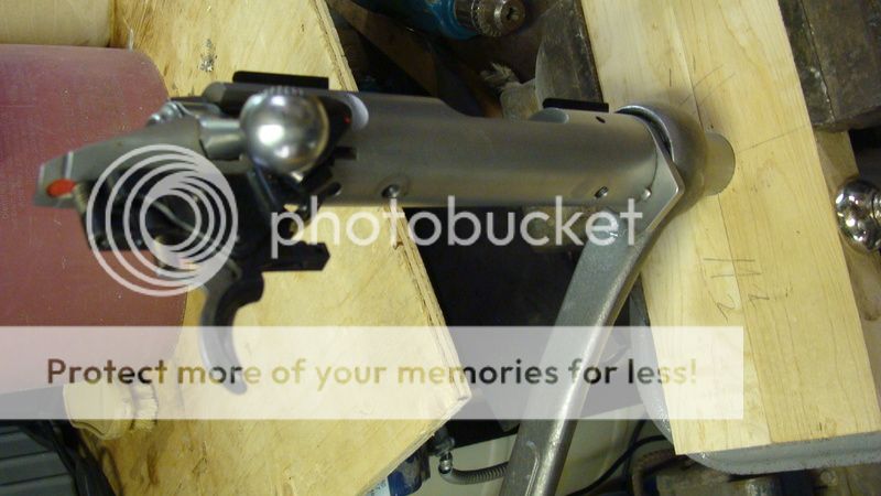

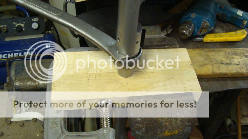

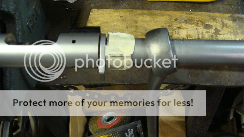

Please don't poo poo this procedure and take if for what it's worth. Proceed to your own comfort level. I wasn't able to get a Savage action wrench so I decided to see if I could come up with a solution other than using a pipe wrench. This was used to remove the barrel on a Savage 10 ML11 Smokeless muzzleloader which is a standard (small) shank.
I got to use an improvised barrel wrench , a 1 1/4 " boxed end wrench that fits nicely over the barrel nut. The points in the wrench lined up with 4 of the splines in the nut .I squared of segments of a few roofing nails to fit in the splines and then I crazy glued them in place before a final wrap of masking tape. The wrench fit like a glove on the barrel nut and splines.
I also made a make shift barrel vice out of some scrape maple hardwood pieces, lined up two 1"X2" pieces clamped them together and drilled a 1 in. hole with a forsner bit through the seam. I lined the hole with a piece of masking tape to help with slippage. I clamped the main portion of the wood jaws in a bench vice and C clamped the other side, a stiff whack with a 2X4 and mission accomplished nut loosened the barrel easily screwed off of the receiver.
Some say Necessity is the mother of invention, and I needed a wrench.
here's a few pics of the set up.
It worked and that is the main thing. I guess I'll have make a wrench of some kind myself.
