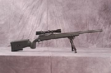

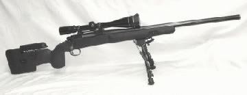

LOL...It's a stevens 200 in 270 win stagger feed. It has a 26" shilen bull barrel with a 1/10 twist rate, bushnell legend 5x15-40, timney trigger, harris 6-9 bipod, a score hi br single shot follower, cheek rest/gear pouch. The forearm has also been stiffened up....
I actually bought it for hunting but with today's quality .270 ammo I figured I can do some precision shooting with it. :p
With that shilen barrel and timney trigger it should shoot pretty good. :)
I just finished inletting and painting the stock on my stevens today to accept a Shilen Bull barrel (223). I have a timney in that one too.
Good luck and don't forget to give a range report.
