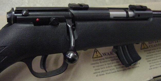

Wondering what rail base to get for a savage mark II F. Does any one have experience with this.
I'm looking to have 2 small picatinny/ weaver bases that are thin enough not to block the open sights view when scope isn't attached.
Thx!
( something similiar to this , maybe a little longer)
Does anyone know what the bases are in the picture I posted ?
Also are rifles tapped and drilled The same to fit all Standard rails ? Or does spacing between screws vary widely ?
Thx
Weaver #16 are the correct 2 piece bases, the rifles usually come with bases in the box.
My 93 came with steel bases which was a surprise.
It came with rings but no mounting rail.
Rings that are mounted right to the receiver are different from rings that mount to a rail ? Or can they be interchangeable ?
Thx
I purchased a pair of "WEAVER TOP MOUNT BASE 24 ZB 22 HORNET, 218 BEE" from ebay few years ago for ~$10usd shipped to Canada. Fits my Savage Arms Mark II F perfectly.
Do the mounts already mentioned have the same base height as the pic I posted ? Wondering which ones are the thinnest
Thx
i was asking my self same question and i did an intensive research. here are your options:
For weaver style:
weaver#16
weaver#24 (most people go this route for some reason)
redfield top mount (much better than weaver but cant find them in canada) - http://www.amazon.com/Redfield-Mount-Base-Pair-Browning/dp/B004U4HG9U
for base and rings in one piece:http://ads.midwayusa.com/product/44...ounting & Accessories-_-DNZ Products-_-447567
For Picatinny style (sturdier):
EGW Savage Picatinny Rail Scope Mount: http://www.amazon.com/Savage-Picati...EGW+Savage+Picatinny+Rail+Scope+Mount,+20+MOA
and finally my favourite OEM Look picatinny is DIP part#SAV-13011
http://www.diproductsinc.com/Detail.aspx?PROD=164826&CAT=3602
note that in canada we have much fewer options. either weaver or EGW
guys i am a new member here, if you think i should remove these links please let me know and ill do. i thought its much helpful to include them to make it easier for others
