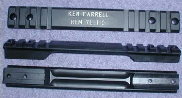

If you don't like extension rings, how about a one piece base or extension bases?

Not the one piece base, its scalloped out on the right hand side to clear shell being ejected. I'd think most manufacturors would know what they are doing in designing them. I'm using medium Burris rings.

either get a 1-piece picatinny rail that will allow you to mount any scope as far back as you like, as well as red dot sights, or look around for an older style long-tube scope.
they hardly make them anymore - almost all new scopes are of the 'compact' tube length - but they used to be quite common. for example a modern scope like a 3-9x40mm is around 12 inches long... the same in an older long-tube scope would be around 15" long.
forget about trying to mount a modern compact length scope on a 2-piece or traditional fixed scope mount. even if you manage to find one that fits you will have absolutely no room to move it further back if you ever need to.
the Farrell Industries base is $80 at Brownells, but a good investment and a very well made steel rail. if you are planning on longer distance shots, the 20 MOA rail is the same price as the flat.
search farrell standard moa at brownells.com to find them. they have 4 types of 1-piece bases for Savage long actions, one for round top and one for flat rear receivers and both come in 0 MOA and 20 MOA variations.
low rings should be fine with these, especially with the 20 MOA version. they are milled out on the bottom and offer plenty of room for loading and ejection (milled out on both sides so the rail is good for right or left hand rifles). mine fit my 700LA receiver perfectly, but i skim-bedded it to the receiver with JB weld for the hell of it.
they also sell an aluminum 1-piece base manufactured by Brownells for $50, but IMO the extra $30 for a solid steel precision base is worth the investment. if you end up not liking it it wont take long to sell in the EE.

There is a standard Weaver base that goes on long action Savages that actually allows for the use of normal sized scopes; I believe the base number is 402. It screws on to the rear, I believe, and extends out over the bolt area.
Yes it is a 30-06 .The one piece base or extension bases will they be in the way of the spent round be discharged from the gun . It is a bolt action.
Contrary to what appears obvious to you the one piece or front extension base will not interfere with the ejection of spent casings. If you wish to continue to use weaver style bases use either a #402 base (402 is gloss, 402 M is matte and 402S is silver) and this will extend the front ring back far enough to mount most scopes. You can also use an extension weaver ring that will project the front ring back. Many people don't like the look of extension bases and or one piece bases like Leupold but thats how you make the scopes fit on long action guns especially the Savage 110's or 116's. Using the Leupold standard one piece base also allows for windage adjustment which is not a bad thing as some Savage's have the base holes drilled slightly off to one side of center (usually the right). Phil.
