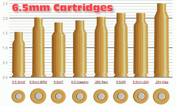

Another thought is that the LRP 6.5 I believe is a 6.5 Creedmoor, where the 12 F Class comes in a 6.5x284, that has more power/velocity for 1000 yards. Shoots the same bullets, but wind drift decreases with increased velocity. The Creedmoor will have longer barrel life though.
