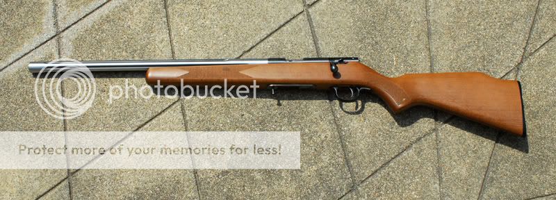

So ive discovered on the internet its possible to swap the barrel on a savage mark 2 with a ruger 77/22 barrel. i have a basic mark 2 in a thumbhole stock but its the sporter not the heavy barrel.

does anyone know any gunsmiths in southern ontario that are capable of doing this job? i would like to put a heavy barrel on my mark 2 ( its a left handed with the pencil barrel)
example
Save yourself a LOT of money, time and hassle... sell your pencil barrel rifle and buy a heavy barrel rifle... probably will cost you under $100 going used for used.
i already have a aftermarket stock for my left handed mark 2 and i really dont want to buy the BTVLSS for 500+ $... :S
Use the aftermarket stock for your heavy barrel MKII... a 5/8" wooden dowel, $3 worth of sandpaper and 10 minutes of your time... best of all you can make it fit like a glove.
