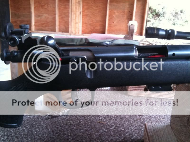

The stock, this is a pretty $hitty stock. Not only does it flex pretty bad, but it is warped and one side of the forestock is nearly touching the barrel. It is for sure nothing to brag about and does not allow me to get any cheek weld, let alone a good one. It's more of a chin/jaw weld.
Secondly, it is shipped without plug screws for the tapped scope base holes... all in all, not that much to complain about, and certainly nothing that can't be fixed with a boyds stock and scope bases... coming soon.

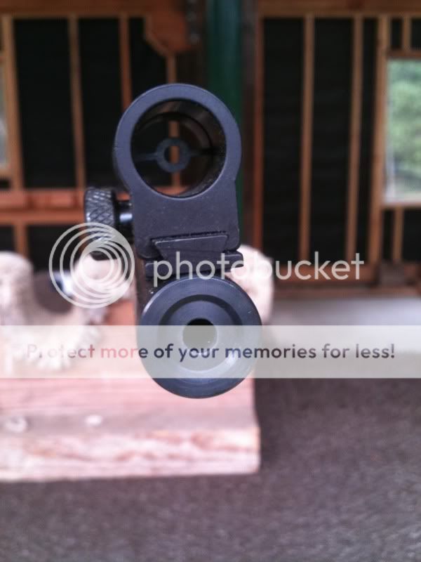

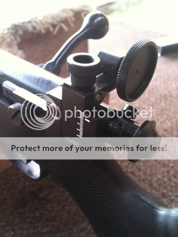

But... to my surprise, williams actually made a decent one. It's solid, audible and tactile feedback is good and it seems fairly repeatable from the limited ammount of testing i've done with it so far. It has adjustment knobs that are 1/4 moa at 100m and it is mounted on a rail that attaches to the side of the receiver. It is also easily removable at the turn of a knurled thumbscrew.
Front sight is also made by williams, and is also removable by a slotted thumbscrew. It comes with 10 different inserts for different ranges/uses... nothing special, but it works and is actually pretty clear. Not as nice as the Lyman globes, but appropriate for this gun.

It is a Williams FP TK of some sort... You could find out by e-mailing or phoning Williams. But it is worth mentioning that it mounts to a rail that is attached to the side of the receiver so you'd have to get your rifle drilled and tapped. I think Williams also has a model that would attach to the rear scope base holes though.

After some further research, I discovered why this gun seems more substantial than the previous savages I owned... The receiver and bolt are way overbuilt! Turns out the new style E-receiver is designed to be used with both .22mag and .22lr and it is WAY beefier than a .22lr needs to be. It also has 2 barrel retaining pins instead of one like the old model. Heck it's even larger and heavier than the old 93 series. No wonder this thing shoots awesome when fitted with a high quality heavy barrel.
