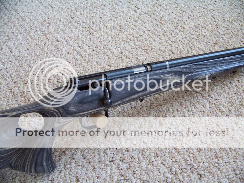

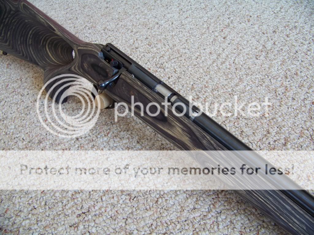

I have been working on a project to build a budget tackdriver rimfire, using a Savage Mk.II F for the action. The inspiration for this came from this thread on Rimfire Central:
http://www.rimfirecentral.com/forums/showthread.php?t=241110
After reading it through and getting inspired, I found an older pre-accutrigger Mk.II F model (the skinny barrel, open sighted version) for $100. Then I ordered a Shilen 77/22 match barrel from Mystic Precision, (16" long, 0.920" no taper) for $250. A thumbhole stock from Boyds was ordered, I caught a clearance deal and paid $79 for a prefinished model in pepper laminate.
The 77/22 barrel appears to have identical tenon details to the 10/22, except it has two extractor grooves where the 10/22 has one. Since the Mk.II needs two grooves, I ordered the 77/22 model to save that headache. The Ruger tenon is also ~0.385" too short to properly work with the Savage receiver. The tenon OD is very slightly too big as well, by about 0.002". I had a machinist friend move the barrel shoulder back the required amount and I used his lathe to polish the tenon down to a slip fit into the receiver. The barrel was bonded into the receiver using Loctite 609 bearing setting compound.
I had a screw up when removing the original barrel and marred the face of the receiver while pounding on the barrel. The machinist trued the face of the receiver up and took a very light cut on the OD at the end to clean up my ham-fistedness. You can see the bare metal at the front end of the receiver in the pics. Once everything is done and sorted, I will touch that up with some cold bluing.
I tuned the trigger by shimming the housing away from the barrel and replacing the return spring with a lighter one. It is now pretty decent, around 3lbs with a very crisp release. The one remaining issue is a lot of overtravel. The final solution may be a Rifle Basix replacement unit, but I will try this one first and see what I think.
I still have work to do, the action needs to be glass bedded, a scope mounted and some tweaking of the extractors as they won't pull a live round from the chamber. The chamber is very tight and the bullets engrave a good 0.060" into the lands, making for a hard pull on a loaded round.
Now the pics:
More details to come and a range report when I get that far.

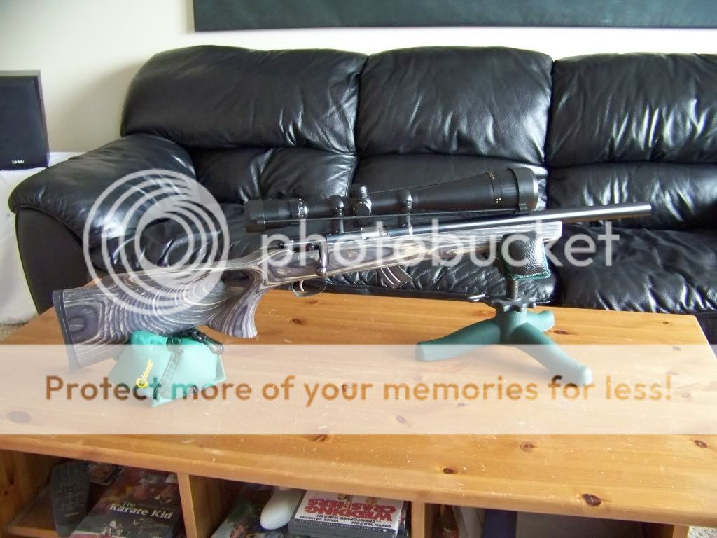

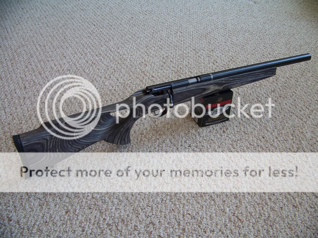

Rifle is completed, action has been bedded and a scope mounted. The scope is a Bushnell 3200 5-15x50AO that I had, it will be replaced with a Bushnell 4200 6-24x40AO mildot when I get to that point. Rings are Burris Signature Zee rings in high. Test drive will be tomorrow if the weather cooperates.

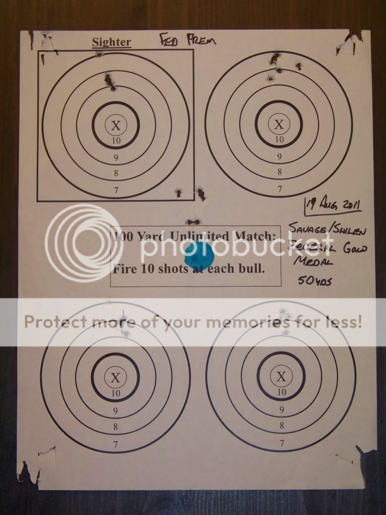

Then I moved on to Federal Gold Medal Match:
The final group ended up at 0.51", again with very little grease ring to work with.

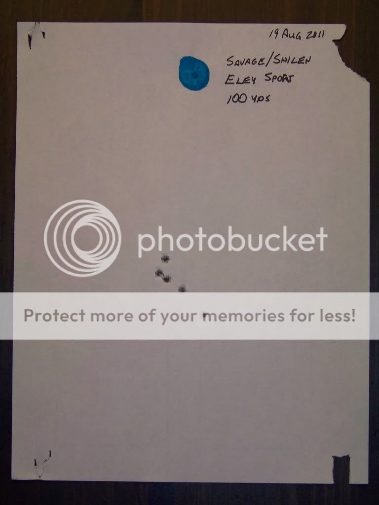

With time running out, I decided to finish up with a couple of groups at 100yds using the Eley Sport.
First group measured at 1.63":
Second group I did a bit better job on the rest, with a more consistent hold and release. It ended up at 0.95", my first ever sub-MOA rimfire group at 100yds. w:h:
I have clearly run into my lack of ability at benchrest shooting, combined with the stock not being a great shape for shooting off a rest and my rest and bag not being anything like a high end benchrest setup. The 0.12" group felt the best, with the rifle sitting easily on the rest and returning to position with no fidgeting. Some of the other groups it took fiddling to get the rifle back on target and I know it wasn't sitting consistently from shot to shot. At the group sizes I am trying for, even those tiny little things will screw up the results.
