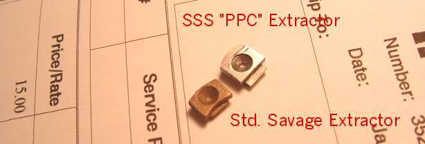

Have any of you converted a Savage over to a PPC head sized cartridge. I have re-barrelled a 223 stevens over to 7.63x39 and opened up the bolt face, but was not able to get the 223 extractor worked down correctly to function with the PPC sized case.

I may just have to get a bunch of 223 extractors and grind them down untill I get one right.
Any other ways to get PPC sized cases to extract?
If Savages x39 is based off the 223 bot head it would work for me. If it is based off the 308 family bolt head it would work on the 308 bolt head only, as the spring is drilled in different locations on the 2 different sized bolt faces.
I will try another 223 extractor and get it to work. The one I did is sooo close but I took a bit to much metal off and got to close to the ball groove. I fired 60 rounds through it this morning with 100% extraction. If you chamber a round and don't fire it it will not extract, as the extractor gets hung up on the ball. When you fire it the recoil jiggles it in to place and surprisingly worked every time... Damm about .003 to much metal taken off.
try changing the extractor ball to a different size.....3.5mm/.140 or ?
try stretching the extractor spring, I have found that they are usually the week link in the first case
