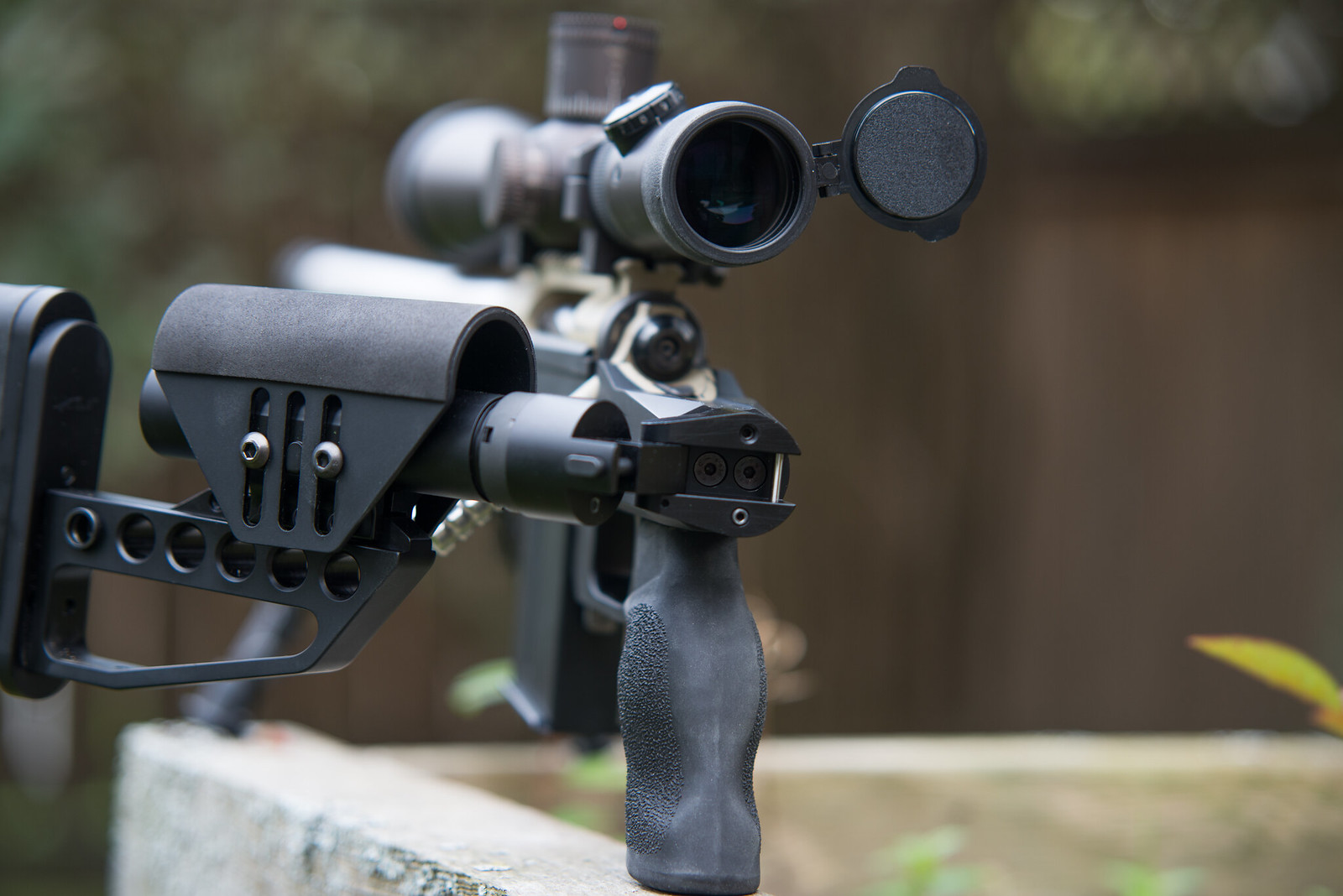

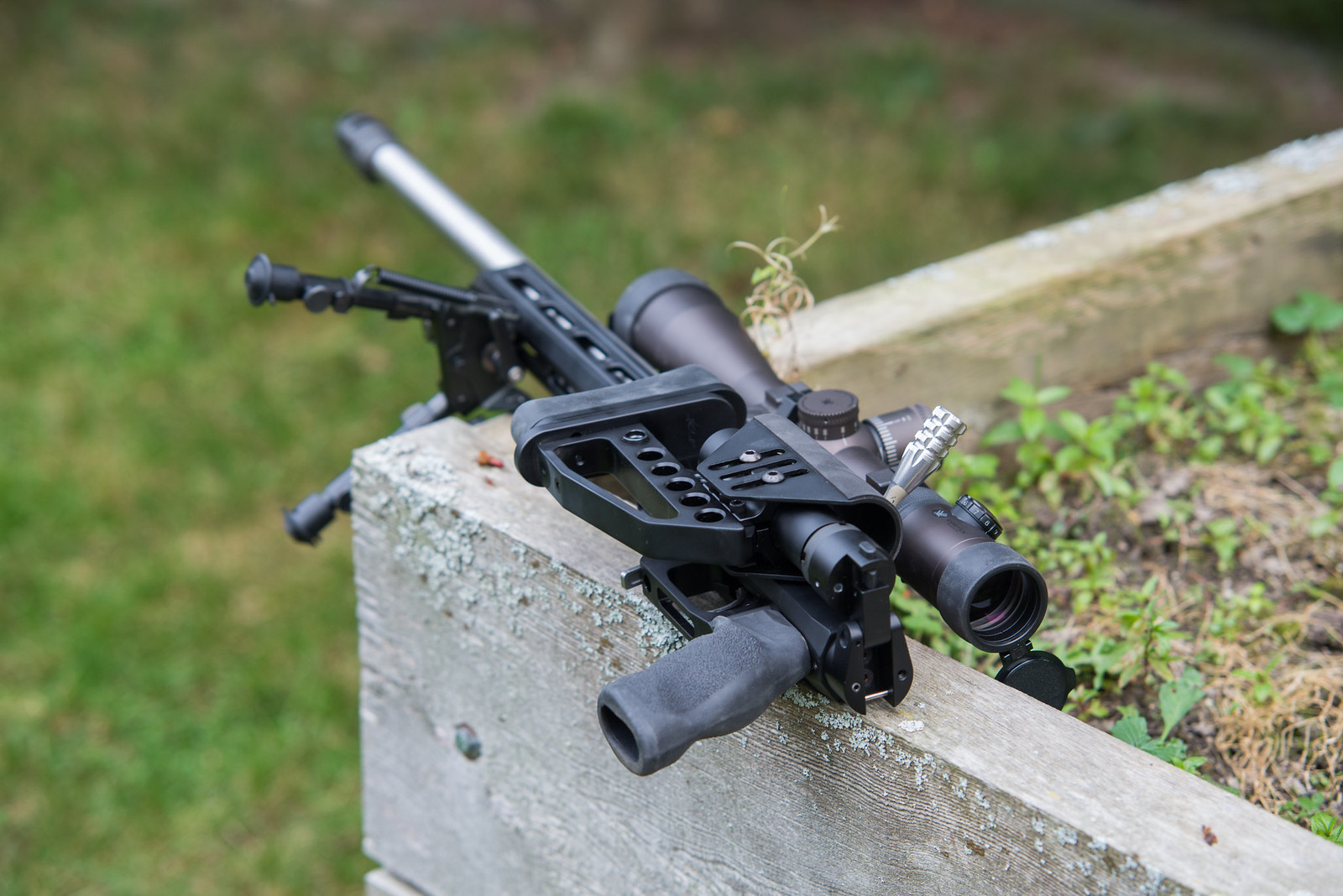

Anyways, here's mine.
Savage WSM S/A (Large Shank Short Action)
PTG Fluted bolt body (OD: 0.901")
PTG Custom bolt face
PTG Bolt Handle
PTG Barrel Nut
PTG Custom recoil lug
ATRS Steel 20moa Rail
Bartlein #9 .260rem 5R 1-8 twist, finished at 22"
Badger Ord FTE Brake
XLR Element chassis w/bottom bolt release and folding stock
Vortex RAZOR 5-20 EBR-2C
Vortex Match rings.

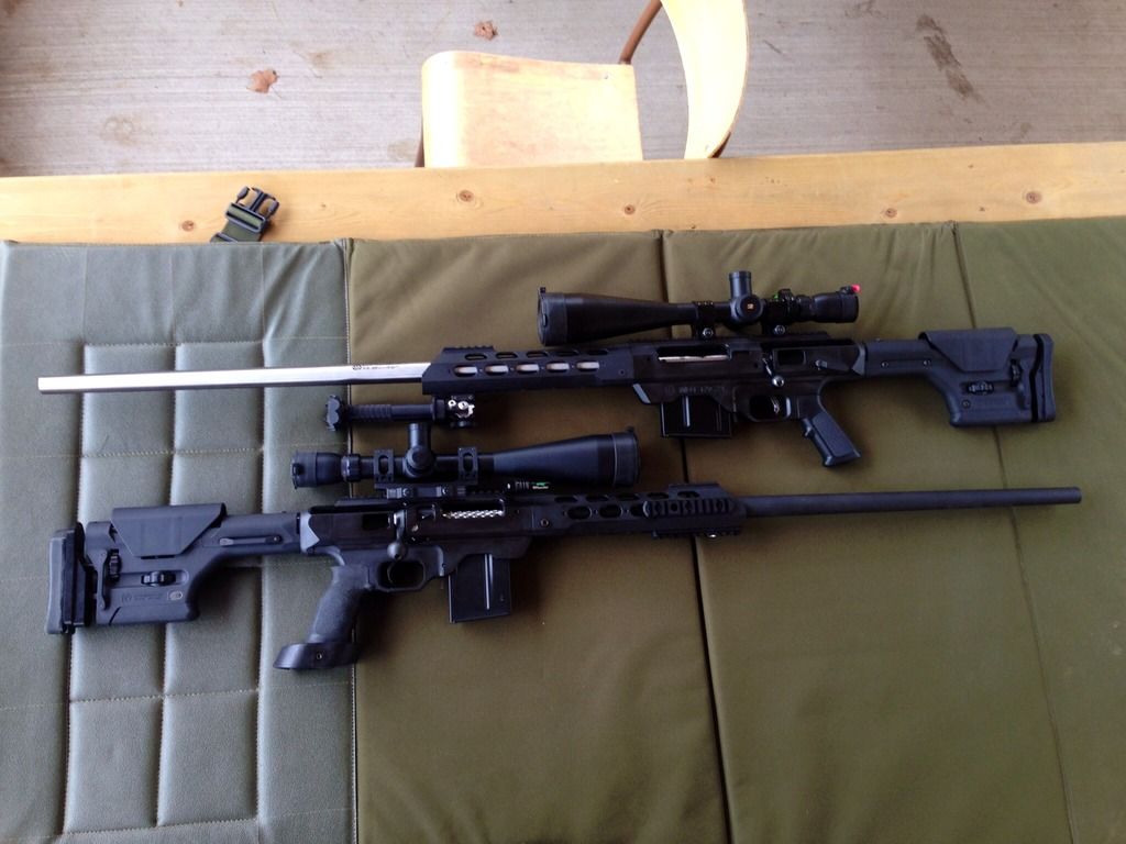

Here's my two, one is short action and the lefty is a long action.
They both shoot. I like the tac 21. Both are Chou builds with glued in receivers and all the goodies. They've both been upgraded with glades bolt handles and ergo grips since this photo was taken.
You have much more stock/bottom metal options if your action have the top bolt release.
IMO when Savage did the bottom bolt release, that was a bad move.
Agreed. My long action is bottom bolt release. It's becoming more popular and any good smith can inlet a stock for it. Mdt and it believe KRG make a chassis that works with bottom bolt release. There may be others now.
XLR makes stocks for bottom release savages...
I just don't get why they did this. Top bolt release works perfect.
