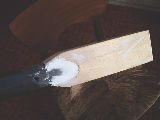

How about this?

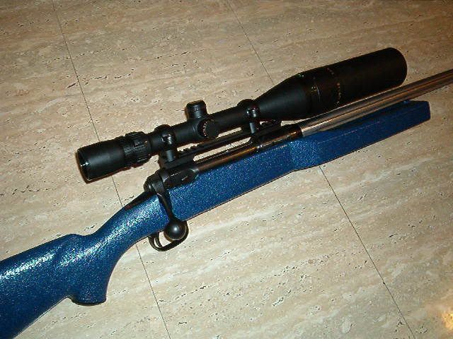

Forend is 3" so that it is a nice fit in my pedestal rest. This was set up as a light weight BR rifle for some 1000m fun. Worked very well.

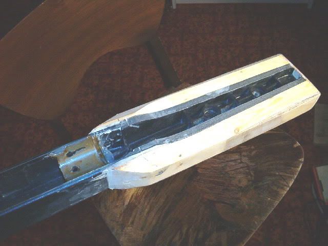

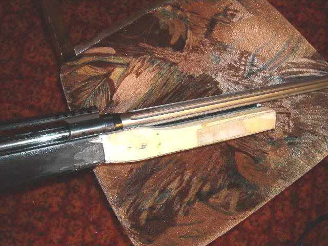

A bit of lumber and thin plywood epoxied to the stock. Sanded, filled and painted. Dirt cheap fun.
Jerry
Epoxy sticks really well to these stocks. Clean the surface well with a degreaser BEFORE roughing up the surface. I use aerosol brake cleaner. Spray liberally and let air dry. Then grind some flats and epoxy the wood on. Don't need nails or screws.
Lumber is good old 2x4's. Any thing will work. The bottom is 1/8" cabinet plywood. You can also use plywood for the sides which will make it even stronger (not necessary but what the heck).

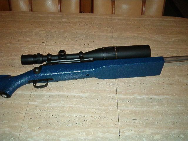

Sand to shape, seal and paint. Voila, let your imagination go.
