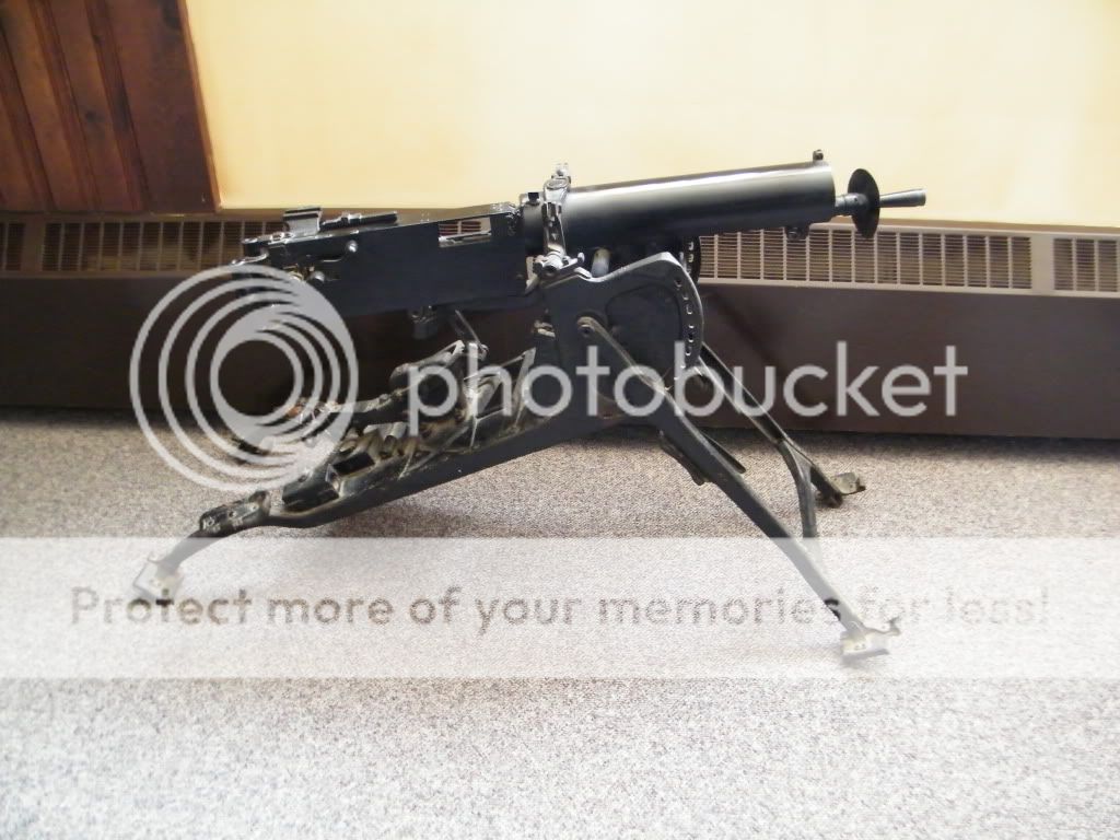

99% sure this is the one we have. I was concerned about internal rusting but it has lasted this long with only gloss black paint on it!
