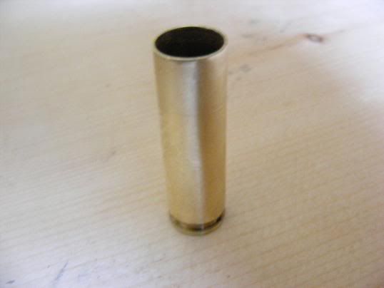

I modelled the case first as you described, but the shoulder is very shallow and I do not think it would work well for a high pressure round..
This one will generate 50,000psi, and drive a .40 cal, 200gn bullet at 2500fps. I think the cartridge will be more accurate with more of a shoulder.
Here is the .40 NC Carbine
