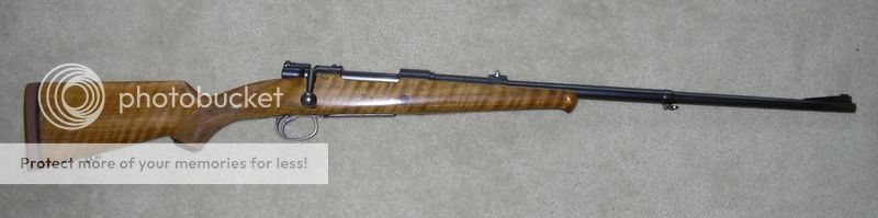

This is my 9.3x62, a nice Husqvarna 1600 that I picked up from Accuracy Plus (they have a nice one there now)
The scope is an old El Paso Weaver V-7 with a post and crosshair. Very light, at just over 7.5 pounds with the scope, and accurate.
