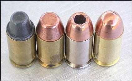

Assuming those guesses are anywhere near correct, wadcutter ammo is specially designed for target shooting. Rather than punching through the paper and leaving a tear, it leaves a neat hole. Is useful for getting precise measurements of group size.
Boat tail bullets have a bottom like this \_/, apparently this does something with the ballistics of the bullet. I'm not sure if it has any affect on tumbling, I'd have to actually look it up. All I know is that boat tail bullets are easier for me to seat in a case when reloading.
Full metal Jacket ammo tends to have excellent penetration with minimal expansion, in some cases it is intended to separate into multiple parts, or tumble on impact, and increase the wound channel. Good for getting around the Hague Convention restriction on using expanding ammunition in warfare.
Jacketed hollowpoint ammunition is sort of the middle ground between wadcutters and full metal jacket. It has decent expansion and the metal jacket allows for faster velocities without the lead core or barrel suffering too much.

heres a decent picture. left to right. SWC, TMJ, JHP, FMJ

TMJ - Truncated Metal Jacket - a conical shape instead of the round shape of the FMJ. Feeds better in some guns. Supposedly.

Its total metal jacket. If you pulled the bullet you would see the base is covered in a jacket too. With fmj the base isnt covered and the lead is exposed.
