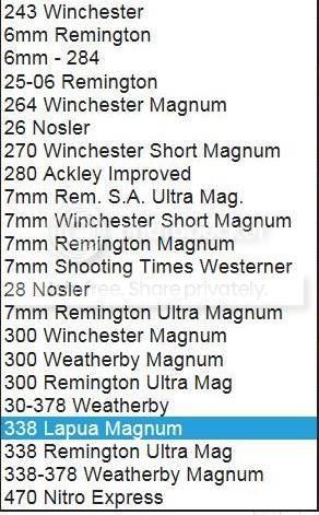

I suggest that you buy all you can find at $20/lb. Retumbo is a very slow powder and thus has limited applications. See the representative list below, and in most cases it's for the heaviest bullets in those cartridges.
At the moment the only cartridge i can reload for on that list is 300wm. However there are a lot on there I would like to own hah. As long as it can store for extended periods i may go clean them out.
