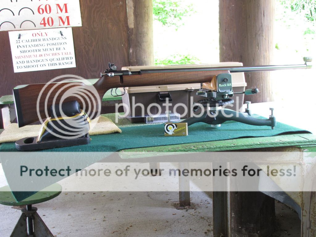

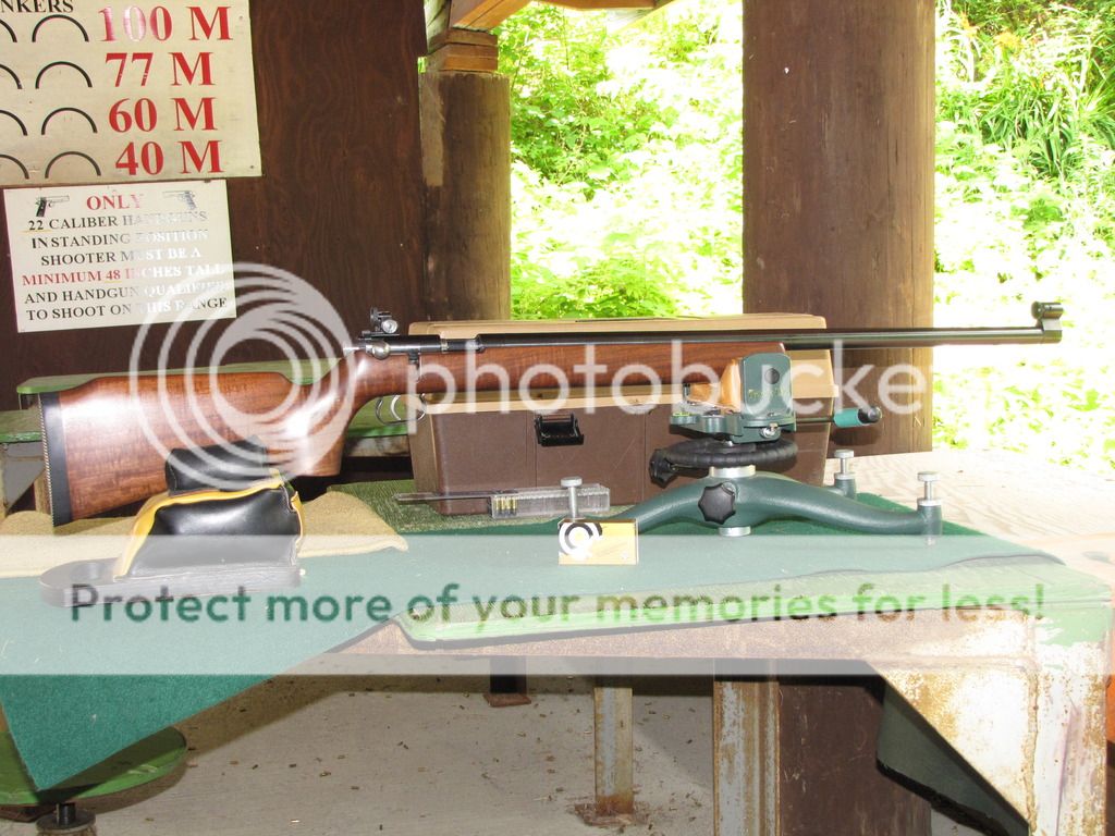

Here are a couple of pics of the one I bought from Tradex.
Thanks for the information Rod.
Nice looking rifle thanks for taking the time to post pictures.

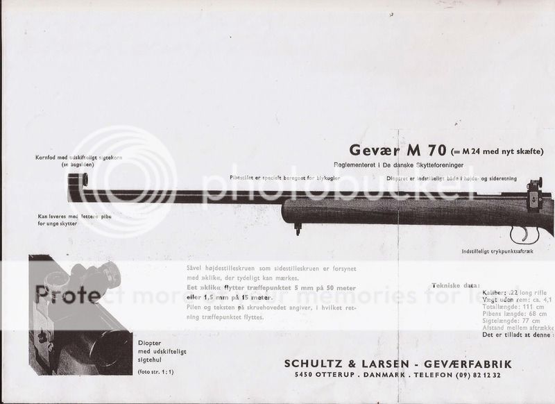

Thanks Hitzy.
By my math that works out to about 3/8 moa per click.
that works out a bit closer, guess I am going to have to shoot every 25 yards to make my own come up chart.
