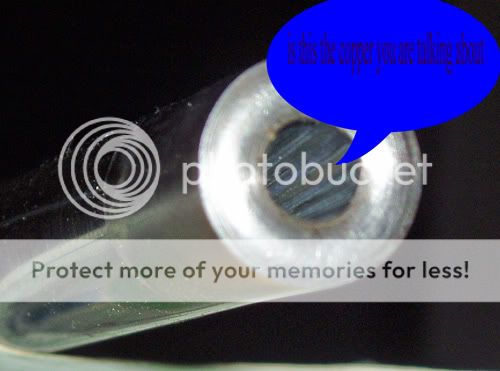

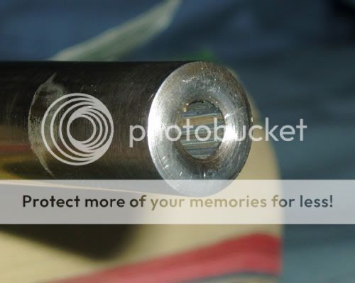

I use a brass brush with solvent, but it may not be the correct stuff. I have taken some photos of the muzzle, in which I think I may have found the problem, ie, copper fouling. I fear I may be straying off topic in the Optics forum, and if so please let me know. Here are the photos;
I will have to take a trip to the gun store, to try and find some of this JB paste you are talking about, if this is what you think the problem is.
Thanks
7.62mm
Great pictures and yes that is copper fouling. See if you can find some Sweet's 7.62 or some other ammonia based solvent. Rem-clean bore cleaner will also work. The ammonia base cleaners will show blue on the patch if copper is still present, but also eat bronze brushes. You need to clean it until he patches come out clean and the copper is gone.

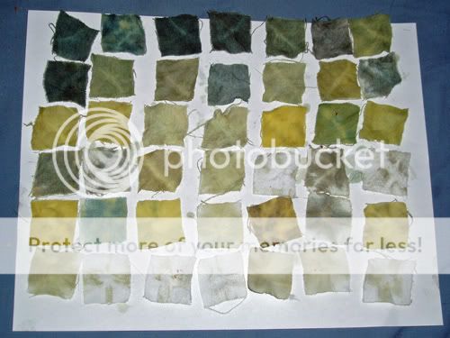

Quick Update:
I am astonished:eek: :eek: :eek: :eek: :eek:
I can't believe what came out of the barrel:cool:
Thanks for all your help, and I will be sure to "clean" better in the future. I could not find any JB Paste that you had suggested, Maynard, my local gun shop didn't have any, but I was able to get HOPPE"S BENCH REST Copper Solvent. I may need to do more work yet, but it is getting better.
I will see how it shoots this weekend and give you a report
Here's some pics of what came out of the barrel,
The patches are in order, left to right, top to bottom.
Thanks for your help
7.62mm
