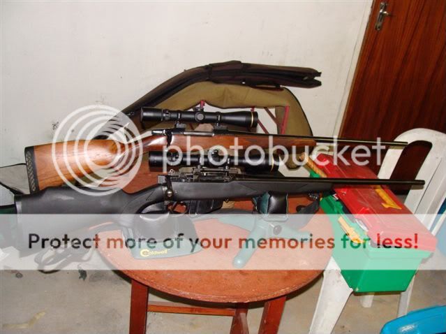

Here's my No4 Mk2 with it's new scope a Leopold VX3 3.5-10x40. The Boone&Crocket works beatiful on the 303. With the 174 gr bullet at 2399 fps I zero the rifle to shoot 2 inches high at 100 yds. It's then spot on at 150 yds and at 200 yds I use the second reticle and again it's spot on! I shot a 3moa 16shot group at 200yds not long ago.
