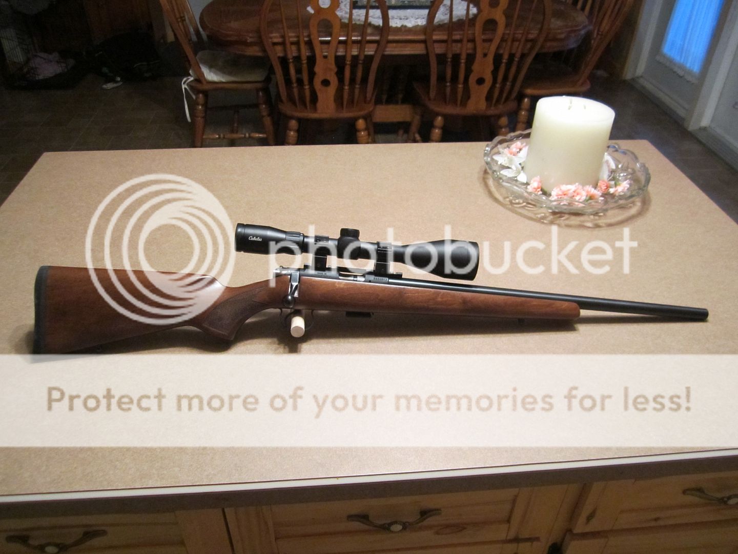

to help you along, i picked up my first CZ452 last year and put a Pine Ridge on it, cost me 230.99 and is a 6-18x50 and i was literally hitting the wings off of wasps.
i put a video up last year when i did, seriously hit the wings off a wasp that had landed on my target when i was doing my initial sighting in.
