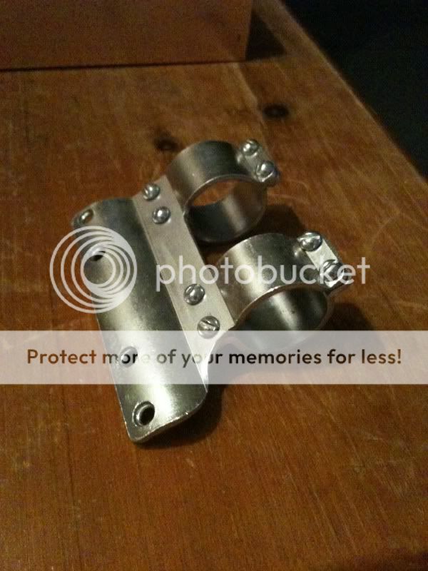

I've got a cooey model 600 .22 and I'd like to mount a scope on it. It has holes drilled in it from who knows when or who knows what scope mount - can anyone identify what type of mount might go in these holes?
The mount you have to buy is a weaver side mount. If you go on line you will be able too see the mount.
The old style is the weaver( very rare to find) but a modern mount is available from Cabelas. it is a two piece mount and you will need the 1 inch rings that go with the first piece. Part numbers are 641202 and 640087.
