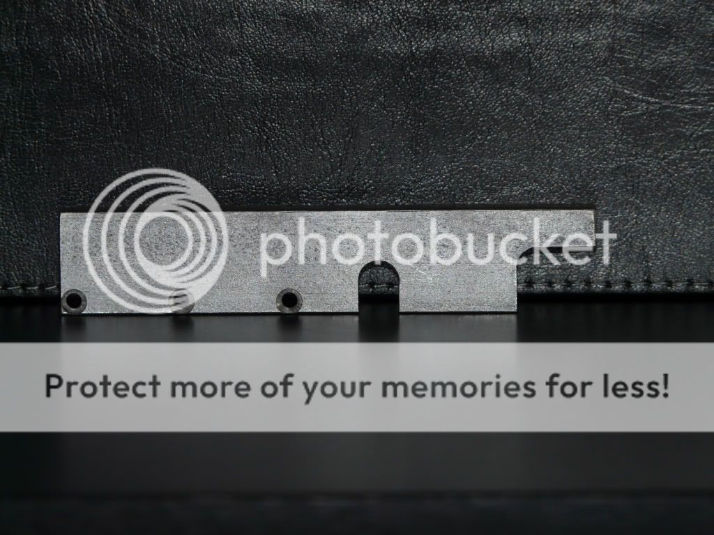

Update with Pics
Hey guys
A little update. So i started with a 5" peice of 1x1 CRS angle. I bead blasted it to remove a bit of the scale and clean it up. I took the measurements off my receiver since it was already drilled and tapped. I milled the ends and edges of the angle to make it strait and parallel. Drilled and chamfered the holes. Next I notched out the slot for the safety and for the other screw that is in the receiver. I still to drill and tap the top to mount the rail to (have to buy of first). Will post more pics when it is finished.
Aaron
Looks good! As for the rail, I have two Weaver bases that are flat on the bottom that you could mount on that.
PM me your address, Aaron, and I'll put them in the mail to you.
