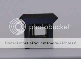

Although it is not intended primarily as a see-through mount,
this 3/4" has some see-through capabilities for using the factory iron sights.
These rails have some other features as well.

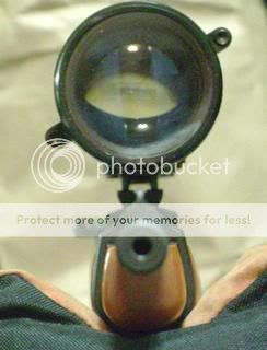

This is the one that is 3/4” tall.
This is a rifle with factory barrel, a scope with a huge 50mm front bell
and extra-high rings.
It uses the 3/4" rail also for the see-through capability.

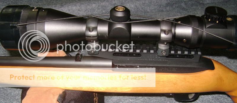

Just bought the new rail from Dlask for my new 10/22 target build, what a nice piece of work. Sure am glad that we have an opportunity to purchase some high quality parts like these that are home grown. I got the 3/8 rail which isn't high enough for what you want but these things are nice. I would recommend them to anyone in the 10/22 market. I paid $30 plus tax for mine which I thought was very reasonable, so here are some pics to tickle your fancy!;)
P.S. These are made with 6 mounting holes and are reversable so you can have the rail extend over the barrel or only on the receiver. Of course they will add some extra rigidity as well. It is easy to drill and tap the extra two holes by mounting the rail and using a centre drill of the proper diameter to mark them then they can be drilled and tapped on almost any drill press. Pretty nice added feature if you ask me. Good work Joe and crew!:D
