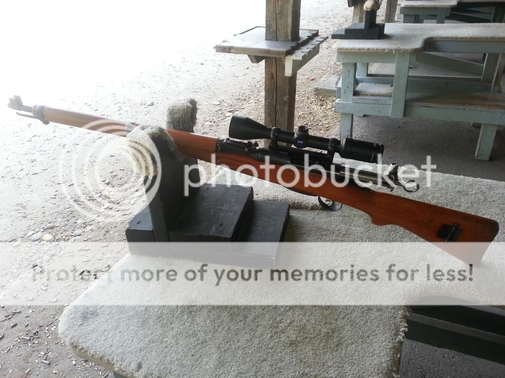

I decided to order the SwissProducts scope-mount and then added a Zeiss Terra 3X 4-12x42 onto the rifle. This thing is just great to shoot, I wish SP ammunition was more available as this rifle would be my back-up hunting rifle in a heart beat.
Here is how the offset looks. The casings now hit the scope and side eject rather than popping straight up and back, landing on my neck.
And here was the final outcome from 5 rounds @ 75 yards. The first shot was the one to the far left. Couple clicks on the scope put me a little over right, but good enough for my liking for now.
