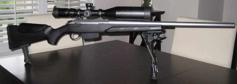

My T3 Varmint has a 4.5-18x56, and it's been GREAT for gophers! :)
It drives me crazy that the 44 has the giant rectangle where the knobs are. I like how the 56 just has that small sphere. Don't know what the story is there.

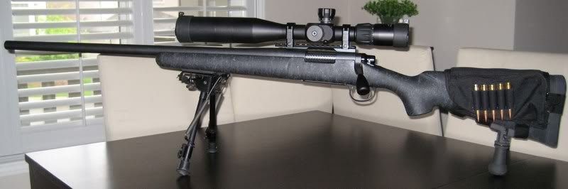

I'm not in a real position to buy a high end type scope. I also need a scope for a Remington 338 Lapua. For this I am going with a Nightforce that is worth 2100 to $2300. Thats why I don't have it yet.

I have thought about another Leupold MK 4, 4.5X14X56 for the Tikka. I have one on my Savage 308 and I'm very happy with it.
We'll see when I have my money together and see what gets the nod at the time.
