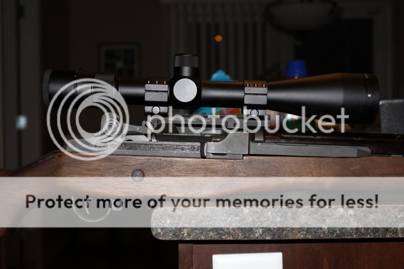

One set the scope was all over the place. 2 sets looks kind of cool and seems to do the trick. The Weavers, which I originally bought for the M14, ended up on my 223 target rifle along with my Minox 4-20x50mm.
Mine has Burris XTR low rings and has a Vortex Viper 6.5x20x50 on a Smith 2024 mount and still has room for the scope covers
The Promag mount has been changed to a Smith. For all purposes they are the exact same mount
