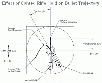

Cost? The height that a rail adds to a scope mount? Canting error?
A proper set of matched rings will not introduce a canting error. The way you mount the scope in those rings might, but lapping and bedding wouldn't help that.
