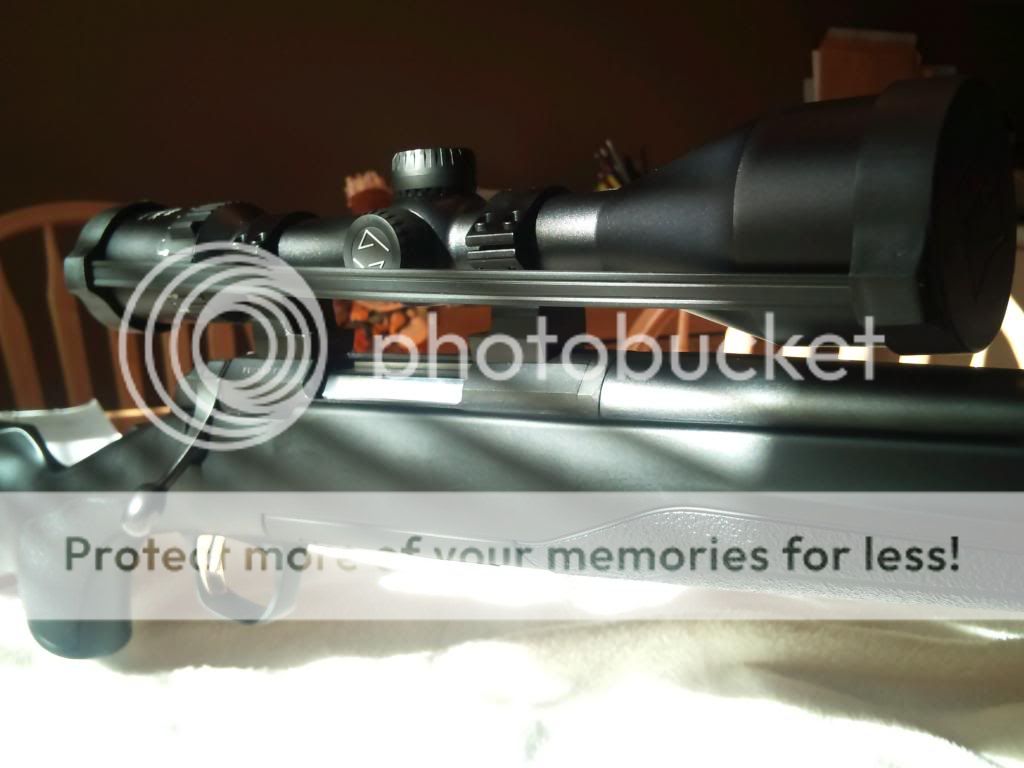

Hi all, as the title say's I'm wondering if anyone could help me by recommending what size of ring's I need for my new scope. It's a zeiss conquest 3-9x50. Im mounting it on an Xbolt varmint stalker, if that matters. If any of you could help me out or point me in the right direction I would really appreciate it! Thank you!

You will probably need high rings for use with the Zeiss, it looks like it is a large model. What diameter is it?

I have found lately i have been using Burris Zee rings and i have been happy with them. With any sort of bolt gun i need at least a medium height ring (in the burris, i have some weaver grand slams that are quite a bit lower for being "medium") or in one case i needed high rings, not so much for the scope not touching the barrel, but for the bolt to be able to pass by the back end of the scope when you cycle the bolt, so keep it in mind with whatever you get.

It's a 50mm objective. I'm under the assumption now that the high ring’s is what I'm going to need. I just haven't found any reference point online detailing anyone else using a 50mm scope on a X-Bolt and what size rings they used. Browning does make their own though, any thought on buy from the relate manufacturer or is aftermarket ones usually better? Anyway thanks very much for the feedback guys.
Well I ended up ordering the 1" high rings, .600. They worked great. There is still a few millimeters of space between the objective and the barrel but I suspect now the medium height rings wouldn't have provided enough for a 50mm scope. Anyway, I just thought I would share this for future reference in case anyone else on here is ever looking for insight into this. Thanks to everyone who responded to my original post.
