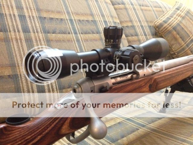

Here's a picture that might help. Rifle is a model 12 with a Weaver 0 moa base and Leupold PRW low rings. Also, it is a Bushnell 10x40 as well. The cheek weld with this setup was fine for me.
I have the same savage model 12 vlp with the same bushnell tactical 10x40 as pictured above mounted with leupold STD 2 piece bases and STD low rings. It leaves just enough room to slide on the butler creek flip-up.
