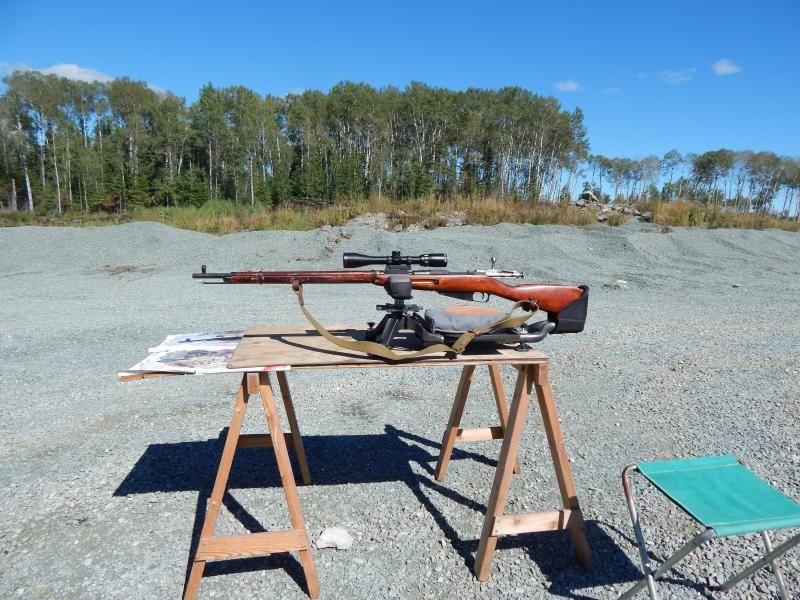

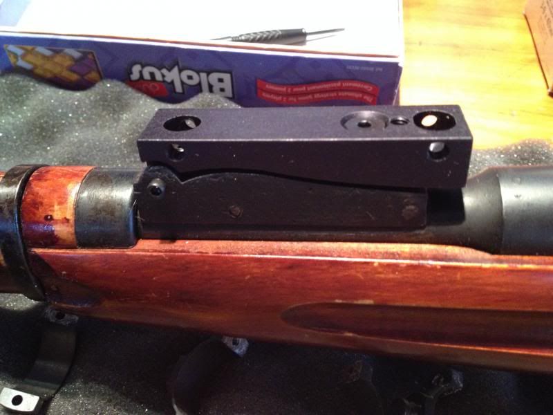

Ordered a scope mount from S&K for my '34 Mosin Nagant.

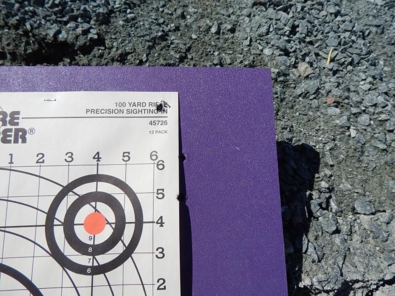

Set the mount up according to the instructions, did a bore alignment, popped off 3 rounds... and this is what I got !!
Bit of a crosswind. I was able to zero it pretty good... good enough for deer !!!

that mount you have is a piece of sh--, i had one and it never held zero for more than 15 shots, so i finally paid a smith to tap and drill it and install a ati mount, it all cost 140 bucks. Then i topped it with a bushnell trophy 4-12x40 and love it.
Well, I'm sorry to hear you had a bad experience with the S&K mount.
I'll give it a whirl and see what kind of results I get.
If it truly does not hold zero then I'll switch to something else.
Thx for your input.
A much better secure scout mounting solution. Is remove the upper handguard. Pop out the 2 cross pins for the rear sight base. Tap it off ( towards the muzzle ) Under there is a tapered dovetail. You can put a 3/8" dovetail adapter on it, and your upper handguard. Its non perminate as well. Can find the adapters for like 20$ on amazon and it held tight on my 91/59 for over 50 shots.
Finally got the Brass Stacker mount finalized and the scope dialed in. Took me 5 shots to get it on paper and zeroed in. The deer better watch out !!
