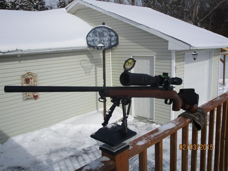

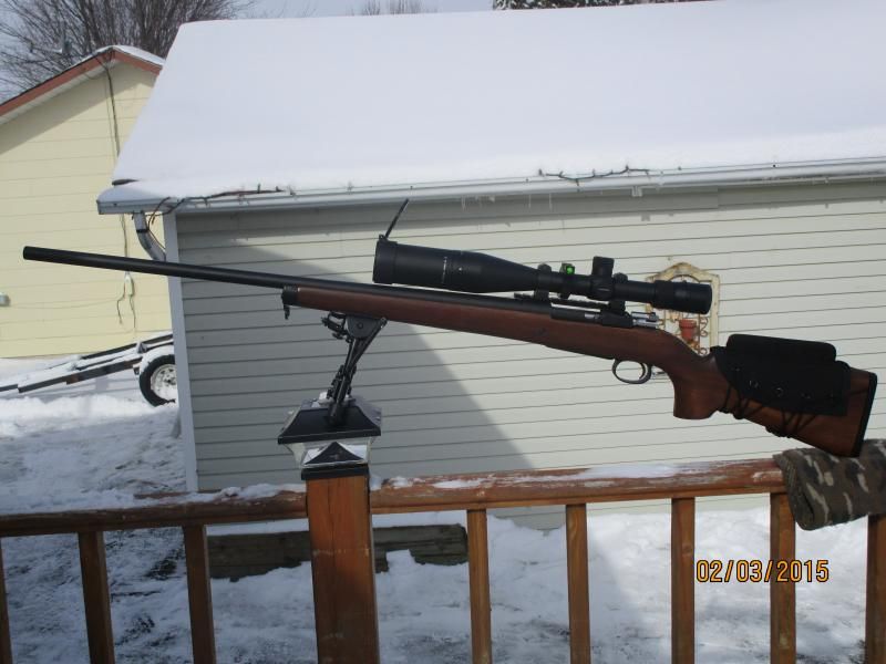

It can be done but pricey. I have a CG63 done in this fashion. Was messed with originally so no issues there. Armurier Lavaltrie in Quebec did the work. Stripper clip guide ground off and a one piece rail milled to fit. Purchased this way but I was looking into having one done in this fashion when this popped up on the EE. This thing really shines out to 1000.
