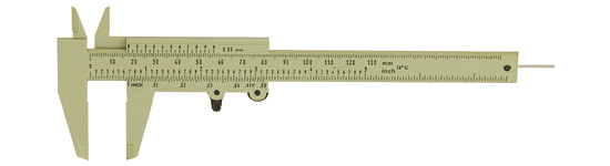

The only measuring tool I had at the time to measure OAL was a green plastic Lyman vernier caliper. And I got tired of counting all the lines on the scale.
I'm retired now and have been reloading for over 47 years and have too many gauges.
And now I remember the good old days when life was simple and the green plastic Lyman vernier caliper I hated to use.
