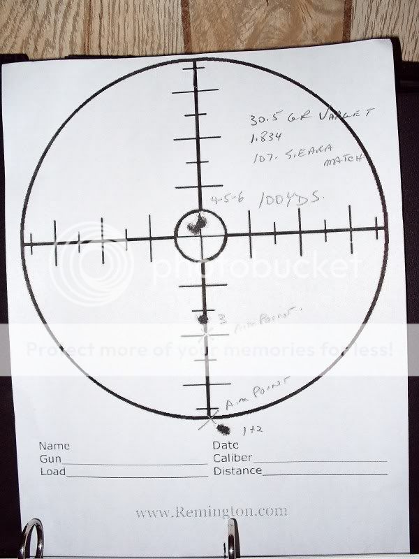

Holy crap I think after 800+ rounds Ive found the right seating depth for my 6BR bullets. 1.839 seems to be were my lands start (long throat I know) Did some shooting on my birthday July 1st starting at 1.834 around 5 thou off the lands and has luck would have it I think the group is close to 1/4 inch at 100yds..
I took 5 more out between 250 and 300 yds ( guesstimate) and was happy to see around a 1.5 inch group, a little more testing and we will see what develops.

Bucky, did you adjust the windage on the scope between 1 and 2 and between 3 and 4-5-6?
If not,The groups are landing in different spots. Try a 5 or 10 shot group at 1 point of aim

Bucky, did you adjust the wind age on the scope between 1 and 2 and between 3 and 4-5-6?
Ian it was a wind age adjustment from my old "0" so I still think I can but a decent group together if I do my part.....maybe tomorrow if the rain quits.
