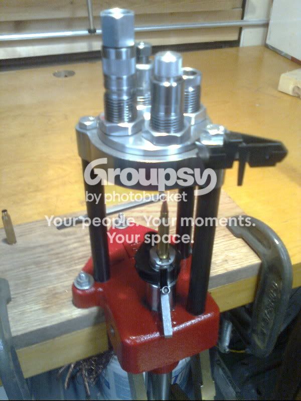

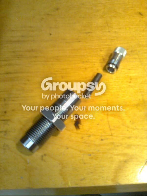

back out the die a half dozen turns, then raise the ram with a shell in the holder all the way. then screw the die in untill you feel it touch... This is the crimping part of the die just touching. back the die off 1/2 turn (or so) and lock in place. Now the bullet seating can be adjusted without the die trying to crimp and push a bullet in at the same time.

The lee seating die can do two jobs, seat and crimp for a three die setup. I think your crimping your case before you reach your desired oal. Try backing the body out 1/2 turn and the seating adjustment in 1/2 turn+. I just use the 3rd station for seating only and crimp on the fourth.
If my seating die can crimp it doesn't mention it in the instructions.. I have a factory crimp die too but I haven't played with it yet
Those are some rounds out of my dies.. Tell me if I'm wrong but there not crimped
