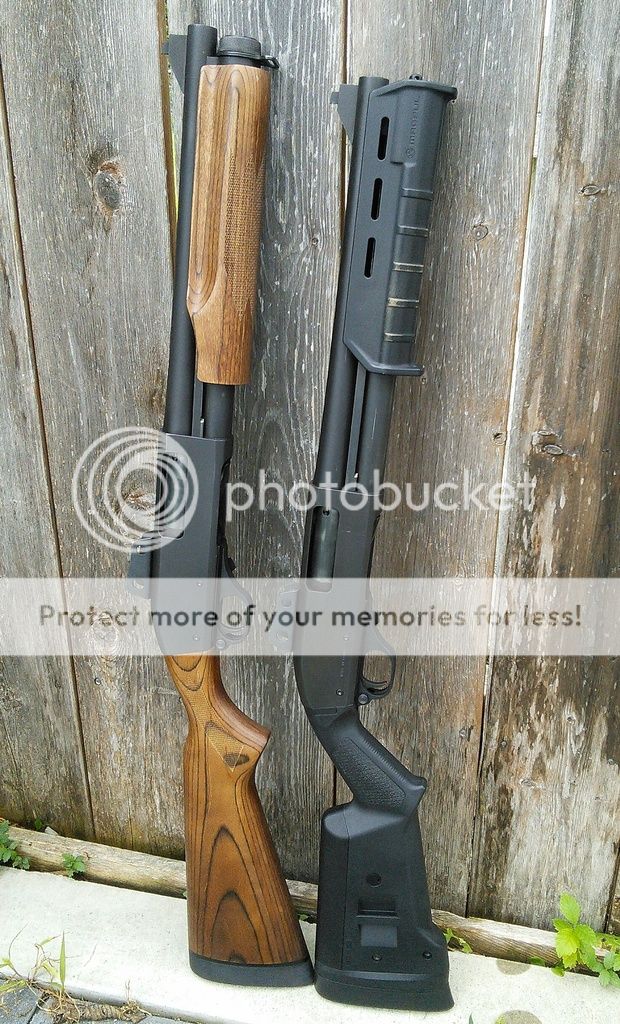

Here's the wear from krylon fusion on my Magpul forend as a result of one seasons regular usage.
It can be touched up, but I couldn't really be bothered at this point.
