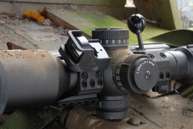

It's been discussed on here before but generally a red dot on a precision rig is used by some guys to transition from target to target without zooming out. The concept being that you zero it so the dot and your scope reticle are aligned at say 600 so you can scan to the next target with the red dot then transition to your main optic and you should be on target. I'm not sure how much better that would realistically work than just zooming down (especially with a throw lever) as you'd have to break your cheek weld to go to the red dot but I've never actually tried that kinda setup so who knows. There's an article on that at accuracytech.com.
I imagine that a secondary red dot could also be used in real world scenarios as a close in optic but I don't think that would apply to most people here...
I think the whole idea behind the ones that I saw anyway, was that if your scope was zeroed at let's say, 500 yrds (40+ moa base, high zoom scope), that the secondary optic could be used for those much closer shots, like 50-100 yrds. I realize that the application would be useless for most people on here unless the zombie apocalypse actually happened.

Well you're right in that I did build this as a dedicated extreme long range rifle. I have others that I can use for closer ranges. My issue is that at around the 17 lb mark unloaded, carrying this gun and kit (I live in Nunavut so it all goes in a pack, on my back while riding a snowmobile/ATV) makes for a heavy load. As such, I don't really feel like lugging other guns with me at the same time. I guess for me, it's not so much of that cool factor, but for the practicality aspect of being able to shoot closer while out with the big gun.

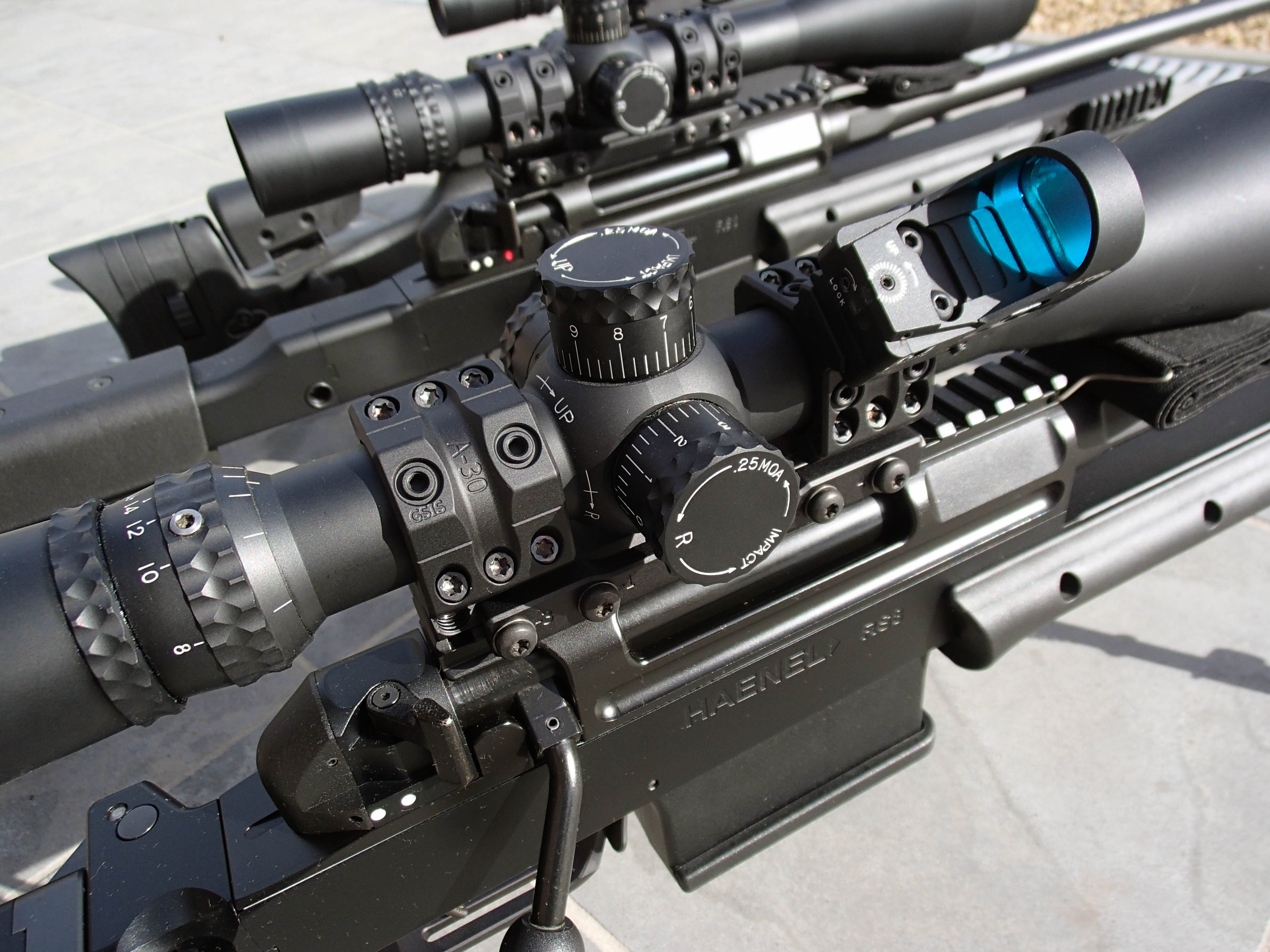

The RDS is for *quick* acquisition moving from target to target if you have your scope at say 25x.
Some PRS stages won't allow you to touch your scope so that's another major benefit of running a RDS.
It's way more precise to use your scope and use your reticle subtensions to hold over on those "no dial" stages, then it is to use an optic with a 3-6 moa dot and no magnification to shoot a 1-2 moa target at 400-700 yards.
You are correct that the best use is for transitioning and finding targets on the clock, if you struggle with finding them under magnification. Some courses of fire will have targets incredibly difficult to find at even 5 power (2016 SHC for example). And no, you do not need to break your cheek-wield if you mount the red dot sight correctly. The red dot sight can also be used as a barricade stop in certain situations/certain barricades.
