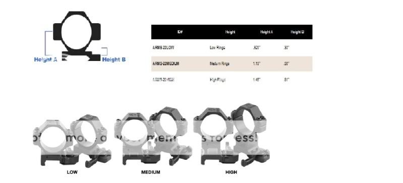

ARMS 22 are good rings .I believe you may need at least the medium ones due to your 50mm objective lens but not sure .
ID#
ARMS-22 LOW Low Rings Height A .925" Height B .30"
ARMS-22 MEDIUM Medum Rings Height A 1.15" Height B .56"
ARMS-22 HIGH High Rings Height A 1.45" Height B .81"
