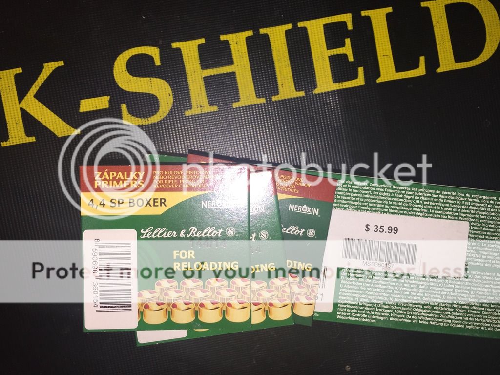

These are my exact defective ones
And for reference, this was around august 2016
And 2 other guys at the club, also purchased the same around same timing as me, but at different retailer
They also did not light 1 out of 3/4

That's a bad batch or mix up between SR and SP.
They're cheaper for a reason. Or multiple reasons. One of them is usually QC. Check the lot number, and next time you go to a retailer, check if it's the same lot #. If it is, refuse to buy it, switch to another brand, or go next door. Make sure you tell the retailer why you do so.
Actually, everyone who got those bad primers should post the lot# in this thread, make sure everyone will avoid them.
