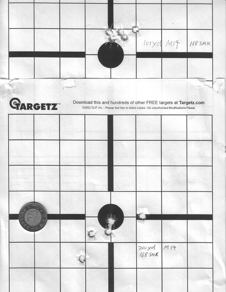

I would say of the M305's I tuned, not one shot worse then 1.5 moa at 200yds with most hovering in the MOA range (handloads of course). That was factory barrels, and bolts (I do not like USGI swaps and especially no 60's bent up op rod spring), using an affordable 2 screw scope base, shimmed gas system, and tuned orig trigger.
There is little doubt such a tuned rig with a Kreiger barrel should shoot that much better. However, we get to the land of diminishing returns where the platform becomes the biggest variable.
I have yet to meet an aftermarket stock that would do anything better then the orig style properly bedded. In fact, those that try and free float the barrel without other serious changes to the action, usually shoot worse.
