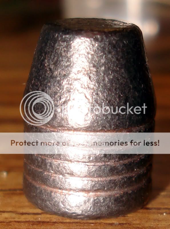

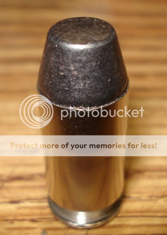

If you'd like to send me some bullets -- just 100 or so -- I can try plating them using a process I developed.
The above are .45acp.
A friend of mine ran my cast 0.452" bullets thus treated through his Tommy and he said it didn't even foul the Cutt's Comp, which is better than he'd seen with even full metal jacketed bullets.
If you like it, then maybe we can work something out in the future, or I can just let you in on my process. It's not hard. I don't know what the rules are about shipping bullets to you across the border.
