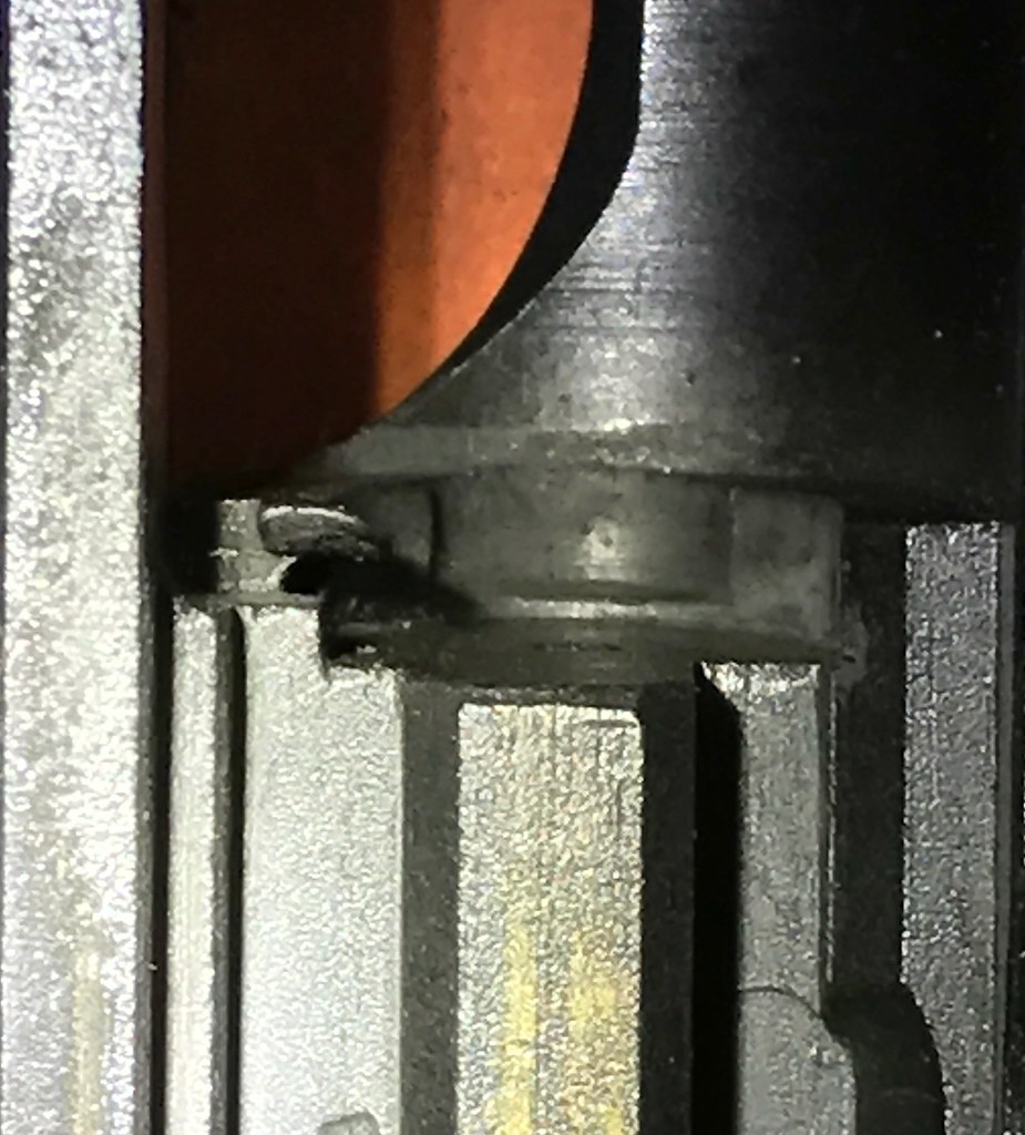

Yes I did after the first few times it happened, then it happened again after a few hundred rounds. Cleaned it out again and the same thing. Does anyone know if the stock extractor that comes with it should have a slight angle on the tip? I see that there are 2 types, one with 1 dot and another with 3 dots on the extractor.
Thanks for the pic, mine looks like that too. After taking it out again and checking it with a magnifying glass, it doesn't look bent and has the 3 dots on it. Looks like I'm going to have to try a new one I guess. It also really only picks up the round on the corner, not the full length of the metal if that makes sense.
